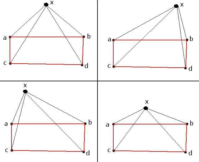

I'm looking for such a tool or software able to find the length of the sides ( xa, xb, xc and xd ) each time i moved the point x, hint that a, b, c and d are fixed and known
please help me this is the last problem in my project

Do I get a mark for working out that this is to do with suspending a TV camera over a football pitch? Well even if it isn't let's pretend it is..
Best approach I reckon is to assume that the plane abcd is the pitich or rather a plane the same size raised above it. Let's call that the xy plane. The camera is then at position x,y,z where z is the height above the pitch (or below the suspension points abcd depending on how you look at it)
Pick one of the points (eg "a" as the origin).
Then pythagorous says the length of the "a-camera" wire is given by
(a-camera)2 = x2 + y2 +z2
The rest I'll leave to you.

You haven't indicated how you control or know the position x. If you know its x, y, z coordinates relative to a, b, c and d then just apply Pythagoras' Theorem as already suggested. If not, what?
Btw, the four distances are related by xa2 + xd2 = xb2 + xc2.

in fact i know the height of point x, however i am not expert in mathematics, can you please support your answer with an example.

If you can't understand pythagorous then this is going to be very difficult.
Start with a 2D problem..
Draw a rectangle on the ground with sides x and y. Then the length of a diagonal d is given by pythagorous as
d2=x2 + y2
or d= sqrt(x2 + y2)
Now imagine you have a pole with a point Z on it stuck in the ground at corner x,y. Draw the triangle from the origin 0,0,0 to x,y,0 to x,y,z and back to the origin. Note it has sides of length d and z
The length of the "3D diagonal" big D from the origin (0,0,0) to (x,y,z) is given by
D2= d2 + z2
but we know d2 = x2 + y2
so D2= x2 + y2 + z2
This gives you the length of one of the wires from the origin to point z.
eg
D = Sqrt(x2 + y2 + z2)Working out the length of the other wires in terms of x,y,z is only slightly more complicated
