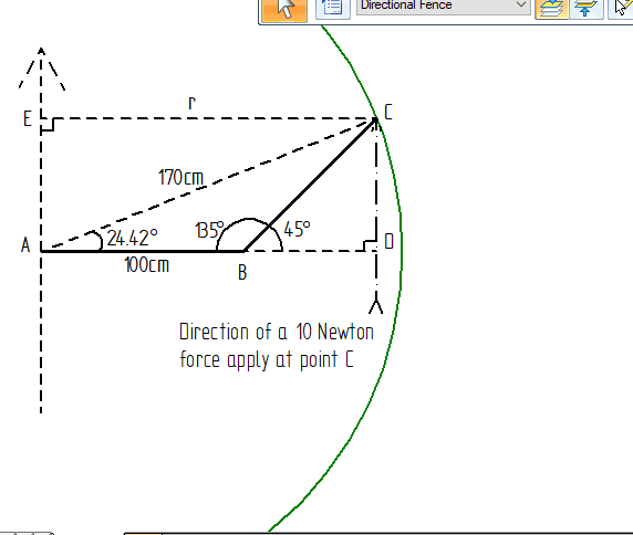

Mike Lessard
Find the torque?
torque = (distance from pivot) * (force) * sin(theta)
