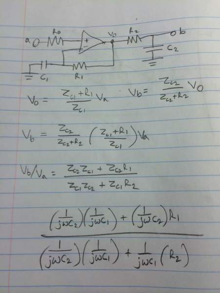

Hello,
I am working on this previous final exam question. I am totally stumped with getting my answer with frequency. I believe my answer is correct with impedance, but I am having a hard time changing this to ω
Here is my attempt on the top circuit
Assuming you made no math errors (your first 3 equations are correct), what's the problem? You have w in your gain expression.

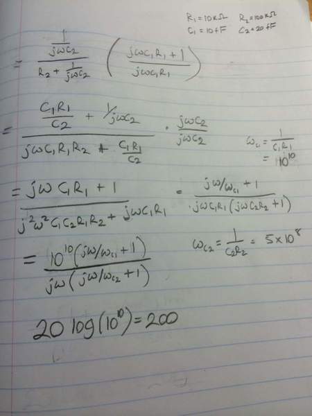

Bode plot? OK, have you been introduced to the Laplace transform? If so, replace jw by s and therefore -w^2 by s^2. Do that with your last expression (I assume you did the math correctly). Then I can help you with your bode plot.
I haven't learned Laplace transforms, we always made the plots in the frequency domain
Just FYI, I think teaching Bode plots without the s variable is cuckoo.
BUT - you're stuck, so:
1. don't multiply by comlex-conjugates as you did in the last line of your sheet 1.
2. (1/jwC1)/R1 + 1 = 1/jwR1C1 + 1 = (jwR1C1 + 1)/jwR1C1
Then the remaining terms are suitable for Bode plotting. Do not go (jw)^2 = -w^2. Leave everything in terms of jw. Your transfer function will always be a function of jw.
EDIT: wait, you have to multiply numerators and denominators by jw until you don't have jw in any denominator of any fraction.

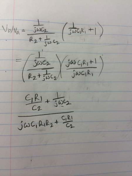

Here is where I am so far. I don't know how this is suitable for a bode plot yet.
I am confused, to make the bode plots, is the idea that the numerator is in terms of jw, and the denominator is all real?
No.
Example: a simple R-C low-pass network has transfer function 1/(1 + jwRC). That surely is easy to Bode-plot. But if you wrote (1 - jwRC)/[1 + (wRC)^2] you'd be all messed up.
Leave everything in jw as much as possible.
Again, what you should really do is change all jw to s but if they didn't teach you that I guess you'd better hold off. Personally I can't imagine doing Bode plots without that transformation. You don't even need to have had the Laplace transform.

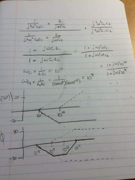

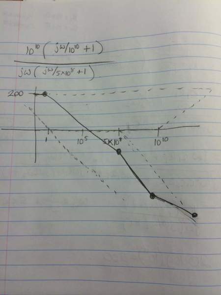

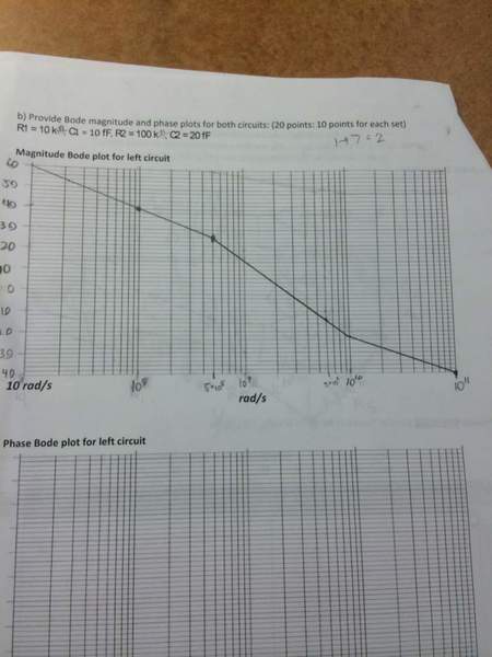

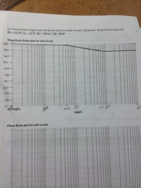

here is my latest work. Now I am running into the problem that I don't have enough cycles on my semilog plot (given on the exam) to put everything in there! that jω pole should go through ω=1. However, my critical values for ω are at 10^10, and 5x10^8. There are not enough cycles to fit that range of frequencies!
I just put bode plots on my regular scratch paper. I'm sure the spacing is way off

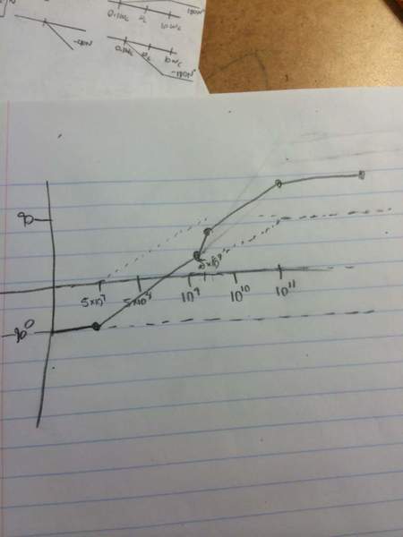

Phase

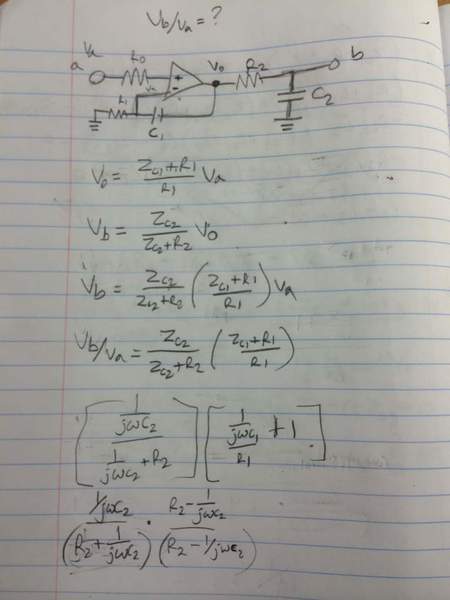

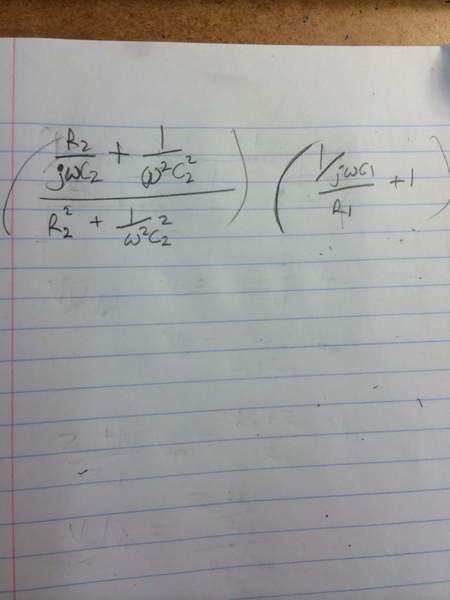

I did the bottom circuit, this one seems to be a lot easier. That one switch of a capacitor and resistor makes all the difference huh??
going thru w=1 is not necessary. in fact, it makes no sense per se. you have plenty of cycles along the x axis. You now nearly have the right form for doing the Bode plots, assuming no math slipups along the way. Just one more change: multiply num. & denom. by w1*w2 to get H(jw) = (1e10*w1/w2)(jw+w1)/[(jw)(jw+w2)].
Now, pick an w << 5e8, say w=1e7. Calculate |H(jw)| at that freq. & plot it. Note that at w=1e7 your |H(jw)| simplifies to ~ 1e10/1e7 = 1e3. Let w=1e7 be the origin along the x axis, then mark off w=1e8, 1e9, 1e10, 1e11, 1e12. That's a total of just 5 decades. Now you're ready to finish the gain Bode plot, right?
Remember, I did not check your math. Make sure w1 and w2 are what you computed, and that they're not swapped in value.
This actually looks good for the gain plot except there is no flat section on the left. There is nothing magic about w=1!
The phase plot looks bad though. The phase angle is -90 solid until w=5e8, then goes even more negative before returning back to eventually settle at -90 for very high frequencies (say w=1e11).
I'll let you determine the break angles. Note the correspondence between the gain slopes and the phase angles.

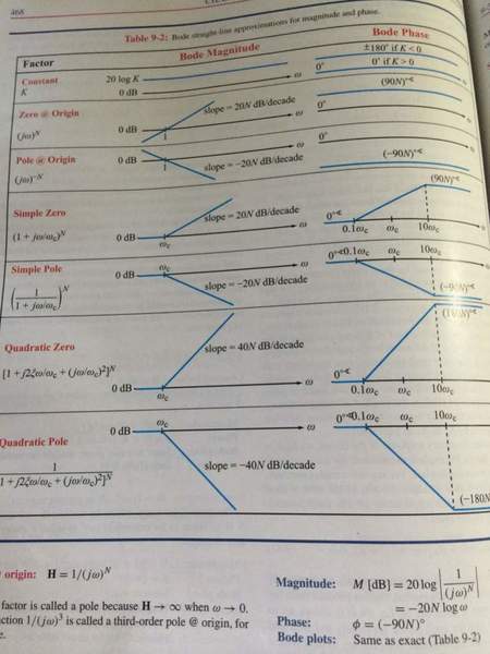

Rude man, I want to show you the table that are given in order to construct bode plots. Basically, the way we do it is that we have to get our transfer function to look like one of the factors here, and then use that to construct the plot.
I want to take note in particular of the pole at the origin. Notice how it has a slope of -20N dB/decade at exactly 1 rad/s. That is what I am talking about in regards to that 1 rad/s that I have included in my bode plot, because I have a pole at the origin in my transfer function.
I see no problem with your table. The desired form is just how I've tried to get you to arrange your transfer function - i.e. as functions of jw.
Your post 14 clearly shows a flat segment from the left-hand end to w=1. This is wrong. The slope runs -20dB/decade all the way from the y-axis to your first break point at w = 5e8 rad/s.
Again - there is nothing sacred about w=1. Do not use it in any way unless your break frequencies are so low as to make that necessary.
A pole at the origin means infinite gain at dc so no matter how low w goes, the slope goesd as -20 dB/decade all the way from the y-axis to wherever the next break frequency is. It does not start at w=1. Even if you could plot for w=1 which you can't, as you yourself pointed out (not enough decades on the x axis!).

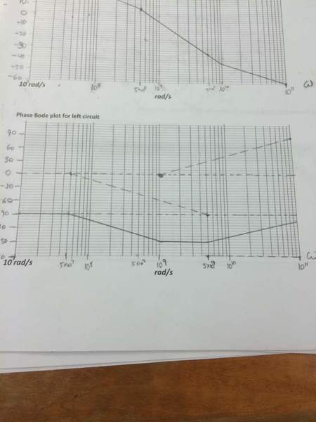

Here is my phase plot
By the way was I right about 40 db?

No, you had 60 dB gain at w=1e7 in your post and I showed you how I got 60 dB in my post 14. It's important that you understand how we got 60 dB. Please study my post 14 carefully. I wonder what put 40 dB in your head.
Don't have time to check your phase plot now. Will try later.
