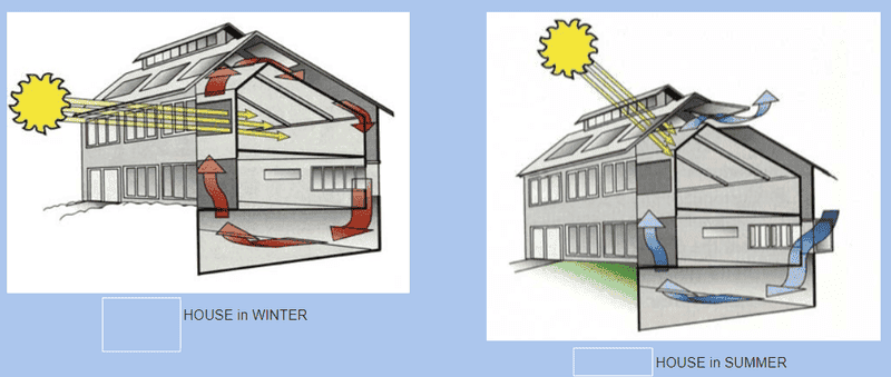

Some folks have used double shelled houses to handle heating. The glass windows are in the outer shell and systems are in place to capture or redistribute the heat where needed.
Here's one example:
http://www.enertia.com/introduction.html
with the addition of the solar glass you could replace or enhance your solar panel energy production.

Didn't the "thorm wall" system use that concept?
jedishrfu said:
I don't know, I've not heard of the "thorm wall" before.
It was in the '70s, I was home on leave from someplace I won't ever go back to. B-i-L was telling me that he was going to make the south wall of his house into a "thorm wall". An additional wall of glass would be added to the outside of the house and vents places at top and bottom. The idea was to heat the air and allow it into the house while cold are would be drawn into to replace it. Never happened, but it sounded interesting.
This drawing from the link in #12 explains it well. Today it could be enhanced with computer controlled open/close, and voltage controlled transparency and even transparent solar panels. I once stayed in a hotel in Trondheim with this type of construction. It is a delightful way to heat/cool, but I have been warned that it is very expensive. With all those enhancements maybe double the price of a simple house.
If you scale that down to just one wall of a single storey house you have what the B-i-L wanted to do back then.
And thanks for helping me prove I'm not nuts. :cheers:
