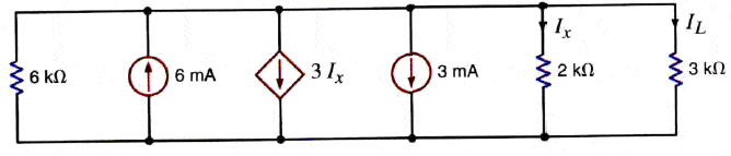

Treat the circuit as a two node problem
  • Topic: Engineering
  • Thread starter Thread starter goldfronts1
    Circuit
goldfronts1
31
Treat the circuit as a two node problem and determine the voltage between the nodes.
Express Ix and the current through the 6k resistor in terms (as functions) of the current Il and use KCL
KCL and ohms laws
I used KCL to fin the currents of Ix and Il and the current I going through the resistor 6k. but all of them were actual values. I found the voltage drop across the 6k resistor which is the voltage for the whole circuit sense it is in parallel.
Show your work and we will tell you where you are going right or wrong.
use nodal anaylsis, since the voltage across all of them is the same. Show us what you tried, and we will try to help
You could combine all the parallel current sources together to simplify the circuit tremendously.
