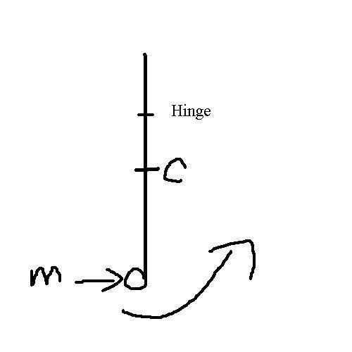

A uniform thin rod (M = 7.29 kg, L = 2.25 m) sits motionless on a horizontal, frictionless table (as in the previous problem). Now, however, it is pinned to the table by a frictionless hinge placed distance x = 0.68 m above the center of mass, and the rod is free to rotate about the hinge. A point particle of mass m = 0.761 kg) moves at speed vo = 77.7 m/s and strikes the rod on the end below the center of mass, and perpendicular to the rod.
Suppose the block is made of clay, and it sticks to the rod. Find ω, the angular speed of the clay-plus-rod after the collision.

Not sure I understand the set-up. Is the rod standing vertically on the table? How does the rod rotate about the hinge? In a vertical plane that contains the line of motion of the block?
Anyway, the impact is clearly inelastic, so energy will not be conserved. You can use conservation of both linear and angular momentum, as long as you take into account that there is an unknown impulse from the hinge at moment of impact of the block. You should be able to eliminate that from your equations.
Here is the diagram I visualize..

The rod is vertical, but there is a hinge ON the rod. This is the thing you should consider.
OK, so I have the right model. What equations do you get for linear and angular momentum?

We know that the hinge is not on the center of rod nor the end. This is interesting, yes? Here is my work..
I = ∫^(x = (-(L_s/2 - f)/L_s) * L, (d)/L_s * L) x²λ dx
= 1/3 * x³λ | x = -((L_s/2) - f)/L_s * L, ((L_s/2) + f)/L_s * L
Here, I treat L_s [the length of the rod] as the dummy variable for the integration. f is the distance between the hinge and the center of mass. Well...
1/3 * λ * [((d)/L_s * L)³ + (((L_s/2) - f)/L_s * L)³]
= 1/3 * λ * L³ * [((d)³ + ((L_s/2) - f)³)/(L_s)³]
= 1/3 * mL² * ((d)³ + ((L_s/2) - f)³)/(L_s)³
So by the conservation of momentum, I should get...
mv_0 * d = (I_rod + md²)ω
mv_0 * d = (1/3 * ML² * ((d)³ + ((L_s/2) - f)³)/(L_s)³ + md²)ω where...
d = distance between the hinge and the end of the rod where it's hit by the block
f = distance between the hinge and the center of mass
L = length of the rod = L_s [This time, I substitute L_s with 2.25 m]
m = mass of the block
M = mass of the rod
v_0 = initial velocity of the block
Let...
d = 2.25/2 + 0.68
f = 0.68
L = L_s = 2.25
m = 0.761
M = 7.29
v_0 = 77.7

I doubt that the rod is vertical.
How could that be if it's pinned to the horizontal table in the manner described?
I would use conservation of angular momentum to solve this problem.
I agree the terminology is puzzling, but I don't know how else to make sense of "strikes the rod on the end below the center of mass".
That is what we are endeavouring to do.
NasuSama, the rod rotates about a point distance d-L/2 from its mass centre, right? So by the parallel axis theorem the moment of inertia to use is ML2/12 + M(d-L/2)2, right?
My take on that is: The "particle ... strikes the rod on the end below the center of mass" means that in the figure the point of contact is below the C.M. rather than being physically below the C.M.
Of course, immediately after the collision, you get the same result for the angular speed of the system, no matter which way you view the situation.
