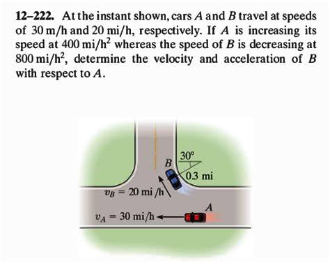

I am currently in dynamics and I know the only thing holding me back is understanding the position of angles, no matter how much time I spend attempting to figure out the trig behind most of these problems I never gain any ground. If anyone can simply and sweetly explain to me why the equation of relative motion (IMAGE BELOW) uses sin(30) in the x-direction and cos(30) in the y-direction, and also how is it possible to use 60° rather than the 30°.
I would be unbelievably grateful if someone can shed light onto what may be the only reason holding me back from the grade I deserve in this class! If you can draw a simple picture that would be beyond fantastic as I am absolutely a visual learner.

Hi Daniela! :smile:
daniiela said:
… why the equation of relative motion (IMAGE BELOW) uses sin(30) in the x-direction and cos(30) in the y-direction, and also how is it possible to use 60° rather than the 30°.
The rule to remember is that it's always cos.
The component of a vector V (such as velocity or force) in a particular direction is always Vcosθ, where θ is the angle between the velocity and the direction.
So the car B is pointing 30° from the y direction, and 60° from the x direction.
So the y component is Vcos30°, and the x component is Vcos60°. :wink:
(obviously, the latter is also Vsin30°)
