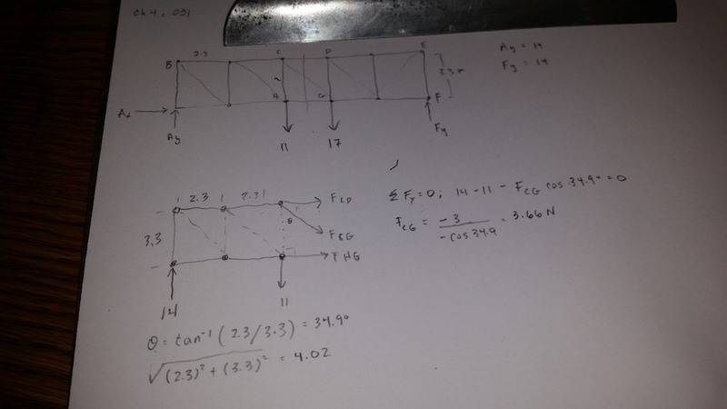

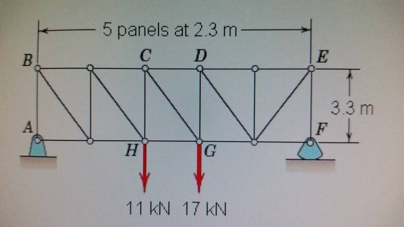

Determine the forces in members BC and CG. The forces are positive if in tension, negative if in compression.
ΣF=0
ΣM=0
im not sure what I am doing wrong here, i think it might be my angle θ?
I got 3.66N tension as my answer but its wrong, i just started trusses and not sure what I am doing wrong.

Your calculations appear to state that Ay = Fy = 14 (kN?)
The structure is not loaded symmetrically, so these reactions are incorrect.
Likes J-dizzal
thank you sir.
