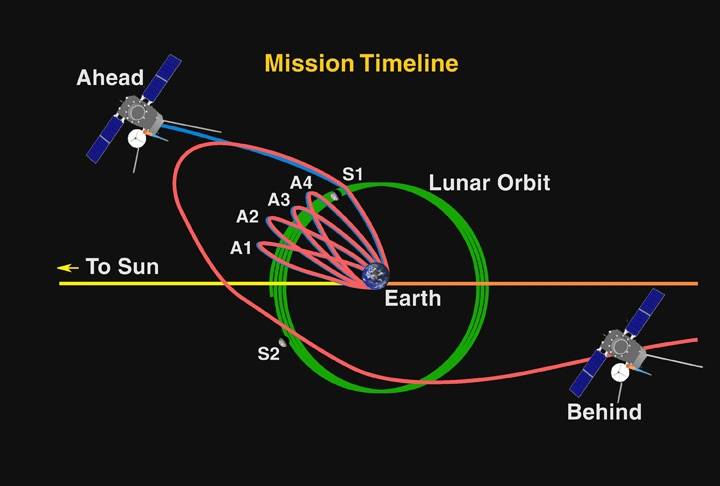

As far as I can tell the term 'Oberth maneuver' isn't used much at NASA. The preferred term is 'gravity assist'. It is a much more generic term than Oberth maneuver. It would be a bit of a stretch to use the term 'Oberth maneuver' to describe the lunar gravity assists used to put STEREO A and STEREO B in their orbits.
