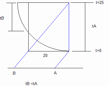

Here is a geometrical explanation for the twin aging problem.
Time is not altered by motion, only the rate of activity and thus time measurement. When the twins separate and later rejoin, the same amount of time has elapsed for the universe, but the two clocks have sliced that time interval into different lengths.
The vertical line representing the height of the triangle, is the time for an object not moving, i.e., the minimum interval. Any motion to the right or left results in a longer/dilated interval. Divide the paths at the change of direction for A. For each segment, rotate the minimum interval to horizontal. Where the paths cross the horizontal,draw a vertical
line. Where the vertical intersects the arc, represents the amount of time for each twin for that part of the trip. The one who travels the greatest distance in a given time, will travel the fastest, and thus have more time dilation.
Thank for your presentation however I am not looking for an explanation of same but am seeking comments in relation to the claim that from the astronaut's point of view, his clock does not tick over at a slower rate than it did before he started moving but that the Earth clock physically ticked over at a faster rate than it did prior to his starting to move.
