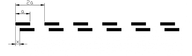

We shine a laser light on two identical diffraction gratings as shown in picture.
Calculate ##x##, if in Fraunhofer diffraction image the seventh peak is missing.
No idea actually. I know how to do this with one diffraction grating.
For one grating all one has to do is compute a product of Fourier transformations of aperture function and sum of delta functions.
For one grating, the result is ##u_p=C\frac{\sin(k_xa)}{k_xa}\frac{\sin(k_xNa)}{\sin(k_xa)}##.
But I have no idea what to do with two diffraction gratings? Is it simply a product of both where one is shifted for ##x## ?
What would you take as:
- the separation of the gratings?
- the thickness of the gratings?
... try redrawing the diagram in a more realistic representation.
There is a clue in the description involving the Fraunhoffer diffraction image... why would there be a peak missing?
