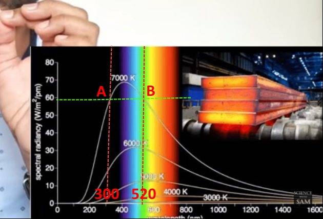

I have questions about Black body radiation. see the attached image
1). It explains that the Spectral radiance measurement of 7000K temperature is the same as both 300 and 520 nm wavelength light.
See here both A and B shows 60.
Is my understanding correct?
2). Is spectral radiance the number of photons? If not, what exactly it is?
Please clarify.
1) Yes.
2) Looking at the units, I'd say the area under the curve denotes a power emitted per area. That's a number of photons per second per area.
No, it is the radiated energy per square meter, per unit wavelength interval, and per unit of solid angle. At optical wavelengths it is rather unusual to express a wavelength interval in picometers. But you can write ## 60 \rm W m^{-2} pm^{-1} sr^{-1} ## also as ## 60 \rm kW m^{-2} nm^{-1} sr^{-1} ##, or ## 6 \rm W cm^{-2} nm^{-1} sr^{-1} ##.
The photon flux is different at the two wavelengths. Because 520 nm photons have lower energy than 300 nm photons, there must be more of them if the radiance is the same.

Thanks for the reply.
When compare with 400 nm and 300 nm we get Spectral-radiance 70 and 60 respectively.
Here, the 300 nm photon has more energy than the 400 nm photon. how about the number of photons, in this scenario?

You simply divide the spectral radiance by ## h \nu (= hc / \lambda) ##, the energy per photon, to get the flux of photons. You get a different curve because the factor is different for different wavelengths.
You have seen Planck's famous formula, haven't you? You can work out all numbers yourself using $$
I_\lambda = \frac {2 h c^2} {\lambda^5} \left(e^{hc/\lambda kT} - 1\right)^{-1}
$$ for the spectral radiance, and $$
\Phi_\lambda = \frac {2 c^2} {\lambda^4} \left(e^{hc/\lambda kT} - 1\right)^{-1}
$$ for the photon flux.

Got it. very clear ! .
Thanks .
Where is this image from? Please give a reference.
