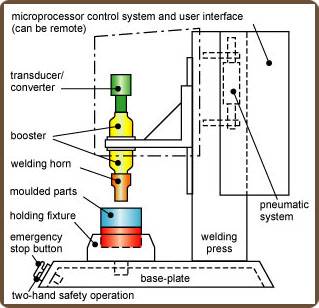

what is the cause of over heating or cracking of ultrasonic horn?

Can you say where you have seen these issues?
In plastic ultrasonic welding process.
You have seen overheating and cracking? Who did the fabrication of the horns and holding fixtures?
http://www.ultrasonicsolutions.in/images/ultrasonic_tech3.jpg
