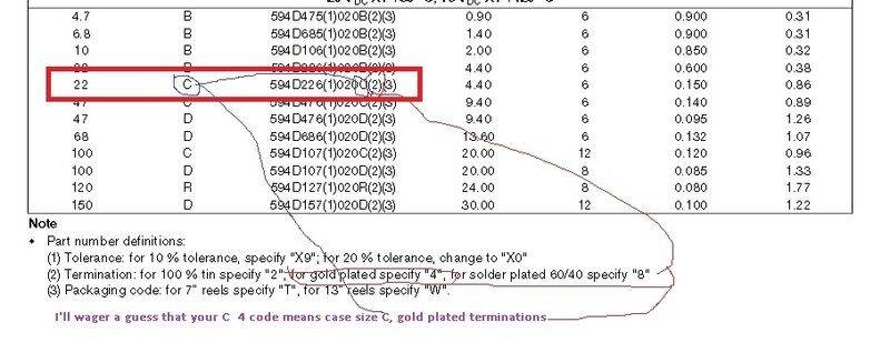

I have recently come across a datasheet for a buck converter regulator that uses the terms "c code" and "No." for certain capacitors but when going to the manufacturer datasheets for these capacitors they make no reference to any "c code" or one single number for a capacitor. If anyone could help me understand what these mean and how to find these specific capacitors from the manufacturers capacitor datasheet I would really appreciate it. The image bellow is where I have been reading these terms.

The title of the chart mentioned surface mount capacitors so the code may be valid for that only.

I looked up that Sprague 594D series capacitor's datasheet.
http://www.vishay.com/docs/40002/293d.pdf EDIT WRONG LINK
use
https://www.vishay.com/docs/40006/594d.pdf
They pack a lot of information in them so you have to acquire a knack for reading tech writers' minds...
I think they're using those two characters for case size and termination type.
Perhaps you can study the AVX and KEMET datasheets to support or refute my hypothesis ?

I suspect it just giving you options. For example if the voltage is 7v and you fit a 33u inductor then you fit...
Two capacitors in position C2 if using AVX capacitors or
One capacitor in position C3 if using Sprague or
Two capacitors in position C4 if using Kemet.
This might be necessary if the caps are physically a different size and have a different ESR.
But I might be wrong.
Sorry I should have included the entire datasheet for the buck converter regulator : http://www.ti.com/lit/ds/symlink/lm2678.pdf
The datasheet sorts the capacitor selection table by inductance because they are recommending certain capacitor values depending on the inductance you have chosen to place on the output of the circuit.

It would have helped if I had linked the datasheet in the first place but I believe the c codes and number refer to a specific capacitor value as they choose some for part of an example circuit.
Thanks for all the responses though, they are much better ideas than what I had come up with myself haha
If you look at the footnotes for that table you will find the meaning of the numbers.

Yeah sorry I discovered I made a mistake and there's actually a table at the beginning of the datasheet that gives the values hahah
