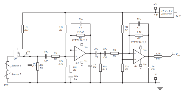

Estimate the quiescent voltages at the inputs and outputs of the two
op-amps and the overall voltage gain (in decibels) of the circuit at the
frequency of operation. State any assumptions made.
None
Hi
I am completely stumped by this question - I have no idea where I am supposed to start with it. I have the answer to part a), which I had no trouble with.
Part B confuses me as I am not sure what the frequency of operation is. Would someone be able to help me to understand where to start with this?
Thanks

So it sounds like you were able to figure out the bias points, and are now asking about how to calculate the gain? Can you take a guess at what each of those two opamp topologies are? That will get you started on the 2nd part...
Sorry that must have been confusing, there are 2 parts to this question, the part a) being related to the 12-5v converter. I forgot I only posted part b), so you can completely ignore anything about that.
Basically I have no idea where to begin - it is a far more advanced circuit than we have seen so far in any of our notes
You should be able to figure out the bias points though, no? You have voltage dividers setting the + input voltages, and ignore the capacitors to figure out all of the DC voltages.
And for the AC analysis, you don't have a guess what kind of basic function each stage is configured for? If not, have a look at basic opamp topologies to see if you can figure it out. Once you know what each stage is basically doing, that makes it easier to answer the question about the gain...

So the capacitors are there to act as a low pass filter for that part of the circuit which i can use to calculate the frequency of operaion here?
Ok so for the non-inverting input of both op amps i just get
Vin = 5(R1/R1+R12)
Vin = 5(22k/22K+33K) = 2V at + terminals
Does that sound right so far?
Edit - the low pass filter seems to be set at 7.23hz = (1/(2*pi*rc))

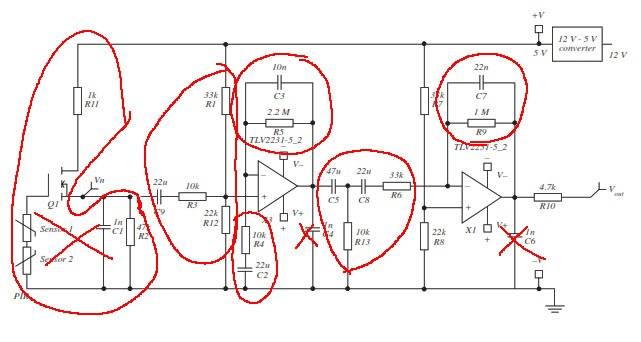

Here are a couple of hints just to make the problem more clear.
1) Because they didn't tell you anything about the sensors and the MOSFET, and because they labeled Vn. You can safely ignore everything to the left of C9. You will assume the input is the voltage Vn.
2) You should also ignore C4 and C6, they were put there by an idiot*. They won't really effect your answer anyway. You can assume that each op-amp solely determines the voltage at it's output based on it's inputs.
I'm not helping you solve the problem, these things are just irrelevant to the calculations/understanding intended and could cause confusion.
*OK, perhaps unfair. That is a very unusual thing to do and it may have been put there for a legitimate, but strange reason. [note to others: typical zo for this part is 150Ω]
Good eye, I missed those. They would seem capable of doing bad things with feedback loop stability...

I am working on the outputs at the moment - the inverting terminals will be at the some potential as the non-inverting terminals due to the negative feedback right?
When you say you are "working" on the outputs, just exactly what are you doing? You should be writing some equations. Show us what you are doing in that regard. You should probably be solving for the response of the opamp stages separately, and when you have the individual responses, you can combine them to get the overall response.
Ok so i was looking at the first op amp to work out what was involved.
So for the gain, I was looking at
Av = - (R5/R4) = -(2200000/10000) = -220
So it looks like each Op-amp has a band pass filter. For the first op-amp, on the left, the high pass filter is C9 and R3 with a cutoff frequency of 0.72hz, and the low pass filter is c3 and r5 with a frequency of 7.23hz so the first parts operates between those frequencies.
2nd op amp's high pass, I went with C8 and r6 as I wasn't sure of the function of C5. Using those, and C7 and R9 for the high pass, i get an operating range of 0.22-7.23 hz
What about C2 and C3?
Do you know how to perform a nodal analysis?
If you work on the first opamp you would need 4 equations involving the 4 nodes I've marked here:
Do you know how to get an expression for the complex impedance of a resistor R in parallel with a capacitor C?
The impedance of a capacitor is given by 1/ (j ω C). Using the product over the sum formula for elements in parallel, you get Z (the equivalent impedance of the parallel combination) = (R * 1/(j ω C))/(R + 1/(j ω C)).
Do you know how to do this sort of complex algebra?
Concerning C4 and C6, it is NEVER a good idea to hang a capacitor directly on the output of an op-amp. I will defend your original statement about them being put there by an idiot.
Now, that being said, many years ago I was likely guilty of doing that exact same thing in some homebrew project before I knew better. If something like this were to ever help prevent an oscillation it is likely an example of 2 wrongs making a right. And that in and of itself is still wrong.

The reason designers like to use op-amp is their (nearly) ideal characteristics. These are infinite input impedance, infinite gain, zero output impedance (for voltage amplifiers). This allows you to solve feedback networks by splitting them easily into parts that don't interact.
So, if you aren't familiar with this yet. First study the simple op-amp configurations like on https://www.electronics-tutorials.ws/opamp/opamp_2.html (there are about a million places on the web for this stuff, I chose this one at random). You will want to first understand and memorize the simplest negative feedback results (inverting and non-inverting circuits). These sites will all initially show you the answers for simple resistors, but in filter circuits like the one you posted you can combine reactive elements into a complex, frequency dependent, impedance. So, for example, R9||C7 can be treated as an impedance Z=R9/(1+jω⋅R9⋅C7). This example is an impedance whose magnitude |Z|=R9/√(1-ω2⋅R92⋅C72) is Z≅R9 at low frequencies, but around the frequency fc=1/(2π⋅R9⋅C7) will start to decrease, at high frequencies it will be dominated by the capacitor C7 with Z≅1/(jω⋅C7).
This approach will allow you to split up your analysis into pieces like I've shown below. Except for their inclusion in the basic formulas, you don't have to worry about interactions between the groups.
