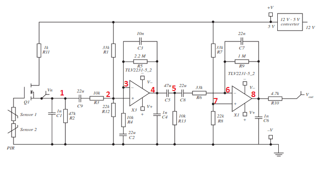

So I estimated the voltage at the non-inverting terminal as 3.707V
(R1*R3)/(R1+R3) = 7674
5V*(7674/(7674+R12)) = 3.707V
Ideal op-amp so this voltage applies across both input terminal
Gain of non-inverting op amp:
Av = 1+ (Rf/Rin)
Rin being R4 here, 10k
Av = 1+ (2.2meg/10k) = 221
Av = Vout/Vin
Vout = Vin*Av = 3.307*221
Vout = 819V
Seems rather high but hopefully I am the right track here?

The 5V is a DC voltage and it's blocked by capacitors.
It looks like you're calculating the quiescent voltage on the non-inverting terminal of the first opamp. You already did that correctly in post #5. Now you're doing it incorrectly.
Av = 1+ (Rf/Rin)
Av = Vout/Vin
Vout = 819V
Now you're calculating the gain of the opamp for the DC on the "+" terminal. The capacitor C2 prevents the opamp from having any gain (other than unity) for DC because for DC the 10k resistor R4 is not Rin. Rin is the series combination of R4 and C2 and the resistance of C2 for DC is infinite. The resistor R5 connects the "-" terminal to the output for DC so the gain of the opamp for DC is just 1. The voltage at the "-" terminal is the same as the opamp output voltage.
The problem statement wants you to estimate the overall voltage gain. They are referring to the small signal gain: https://en.wikipedia.org/wiki/Small-signal_model
The AC signal at Vin is at a frequency of around 1 or 2 hertz, but it is a small signal, probably only millivolts.
The incoming small AC signal passes through C9 and R3. Those two components appear to be high pass but their output is loaded by R1 and R12 which changes the frequency determined by the C9 R3 pair.
Also, the small signal which has passed through the C9 R3 pair is decreased in amplitude because of the loading from R1 and R12. Note that for small signal purposes, the 5 volt line is a ground for small signals so that R1 and R12 are effectively in parallel as a load on the C9 R3 pair.
For small signals the series combination of R4 and C2 serves as Rin in the formula for non-inverting gain, but you must calculate the impedance magnitude |Z| of the R4 C2 series connected pair to use in the formula.
The formula also needs a value for Rf. This value will be the impedance magnitude |Z| of the parallel combination of C3 and R5.

this is really helpful. Thank you. As soon as I get a chance I’ll have another shot at this
Hi, peasngravy, any luck on your latest efforts?
Hi - I actually tried building this circuit in pspice to help me understand it a bit better yesterday but I didn't have much luck.
Most of my learning material was in my workplace so I didn't have access to a lot of it over the weekend so I am looking through this now.
I was confused on what the AC input signal (vin) is though, the one you said will be in mV - i am not sure how to calculate that
You don't calculate Vin--it's a given. You assume a sine wave of voltage at a frequency of 1 Hz is applied to Vin. I like to assume that the voltage of the input is 1 volt AC, but any voltage is OK. Then you calculate the way this voltage signal is amplified as it passes through the circuit. The voltage at Vout is your final result. The voltage gain is then given by Av = Vout/Vin.
In the real world the voltage at Vin due to the sensors will probably be on the order of millivolts, but for your problem since it's just math, you can assume any Vin. Since the circuit is being treated as if it's perfectly linear with unlimited output voltage capability from the opamps for the purpose of doing the math, any Vin will do.

Based on the frequency response of the circuit, it appears that the operating frequency is about 1-2 Hz, not 1-2 kHz.
Well I wish I asked you that much sooner as I spent a long time on google trying to work it out :D
In pspice you simply connect an AC voltage source to Vin. Set the parameters of the source for your desired frequency and voltage amplitude.
Given that it's an ideal op-amp and the gain can't be anything other than unity, then all inputs and outputs of the op-amps are 2vdc?
And I just need to perform a small signal ac analysis to work out the overall voltage gain?

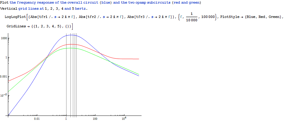

Have you tried to derive the non-inverting gain of just the first opamp stage using equivalent impedance of the C3 R5 pair as Rf, and the C2 R4 pair equivalent as Rin? Ignore the effect of C9, R2, R1 and R12; they are just a voltage divider in front of the "+" input of the first opamp.
I did calculate those pairs - using 1hz frequency, I got Z values of 16.06Meg and 12.34K for those which gave me a gain of 1301 (1+(rf/rin))

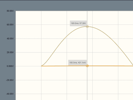

I checked this on circuitlab (with an AC source at 1V and 1 hz) and found the value did not match up so I am a bit lost now. This gave me a gain of around 135. These are the values
Simulator plot of two voltage traces against time from 0 to 80.00V and down to -40.00V; a tan curve peaks near 57.29V at 180.0ms, and a flat trace sits at 421.1nV, both marked with cursor labels.

You need to carry more digits in your arithmetic.
When I carry out this division: (2179000/12342) I get 176.55161238
After adding 1, I get 177.55161238
But carrying more digits in all the calculations, I get the desired quotient as: 2179278.18/12342.4196 = 176.568148
The after adding 1 I get: 177.568148
What do you think the correct result is, and where did you get the value you believe is correct?

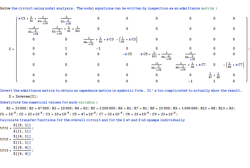

You will get a tiny error in your calculations because you aren't using complex arithmetic. When you add 1 to the quotient of the two impedances, the impedances should be kept in complex form for the exactly correct final result which is: 177.4516107
I don't think spice will give you that many digits, but that is the exact correct result.
Your problem statement asks you for an estimate. I would say you have a very good estimate, but do carry a few more digits so your result is 177.55, not 176.
Next, what is the ratio of the voltage divider made of C9, R3, R1 and R12.
Then, show your work for the second opamp stage.

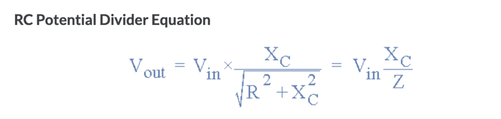

For the voltage divider you mentioned, can I use the Z value of C9 and R3 in there?
The signal coming in at Vin passes through the series combination of C9 and R3. Calculate the |Z| of those two and that forms a voltage divider followed by a resistance to ground equal to the parallel combination of R1 and R12, with the output of the divider applied to the "+" input of the opamp. You will multiply the voltage divider ratio (which will be less than unity) times the gain of the first opamp. That will give the gain from Vin to the first opamp output.
Then you will calculate the gain of the second opamp and multiply that factor into get the overall gain.

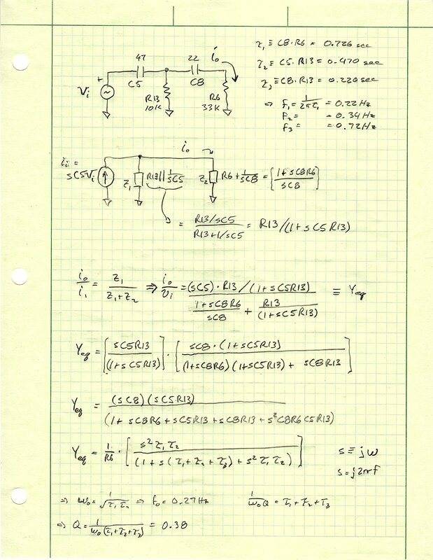

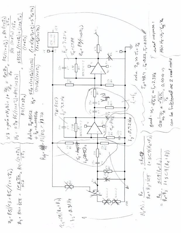

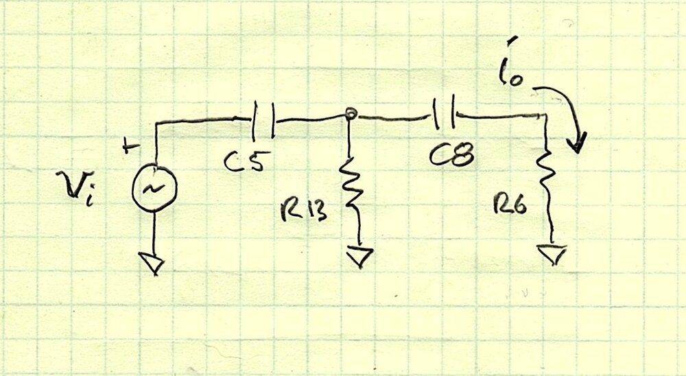

The key problem for solving the 2nd amp is dealing with the C5/C8 network at the input. Because the virtual ground of the 2nd amp will keep the AC (signal) voltage = 0 at the input (BTW, don't confuse this with the non-zero DC voltage there), this problem amounts to given a signal voltage applied at the 1st amp output, what will the current flow be into the 2nd amp. That current will have to flow through the feedback components to create the output voltage. Something like this picture:
Hand-drawn circuit schematic on graph paper: source Vi with series capacitor C5, a node with resistor R13 to ground, then series capacitor C8 feeding resistor R6 to ground, with current Io labeled leaving toward R6.
edit: note that you will end up with an equivalent impedance Zeq = Vi(jω)/Io(jω), although I phrased it as an admittance (i.e. find Io given Vi); whatever, there sort of the same, in a reciprocal fashion, LOL. Then you can pretend it is a two terminal complex impedance, if you like to think of things that way. BTW this Zeq simplification only works for Vi and Io, it won't be correct if you want to know other things in the network, like the current through R13, etc.
Hand-drawn circuit schematic on grid paper: AC source Vi with a + marking feeds series capacitor C5 to a node with resistor R13 to ground, then series capacitor C8 to a node with resistor R6 to ground, with output current io shown by an arrow.

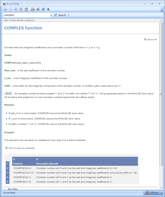

I can't find a way to use j, excel and my calculator do not like it

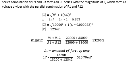

Edit - i will show my working up to this point. I am very close now, thank you allfor guiding me this far
Series combination of C9 and R3 forms ad RC series with the magnitude of Z, which forms a voltage divider with the parallel combination of R1 and R12
Handwritten-style worked calculation of an RC series impedance magnitude |Z| = sqrt(R^2 + 1/(wC)^2) with w = 2pi f = 6.283, giving |Z| = 12342, and R1 parallel R12 = 13200 ohms, then 1V voltage divider output 515.79 mV at the first op amp terminal.
So AC voltage at output of first op amp = 515.79 * 177.658 = 91.765V
I had written this in word and for some reason the equations don't copy over so had to screenshot
  • Handwritten-style worked calculation of a voltage divider: |Z| = sqrt(R^2 + 1/(wC)^2), w = 2*pi*f = 6.283, |Z| = sqrt(10000^2 + 1/(w*0.000022)^2) = 12342, R1||R12 = (22000*33000)/(22000+33000) = 13200 ohms, and voltage at first op amp terminal = 13200/(13200+12342) * 1 V = 515.79 mV.
Your procedure is correct, but there are some small arithmetic errors.
The value 515.79 should be .51579 in the following calculation, but even then the calculation you show is giving a slightly wrong result: .51579 * 177.658 = 91.765V should be as shown below:
Calculator-style arithmetic: 13200. divided by (13200. + 12342.) = 0.51679; 515.79 * 177.658 = 91634.22; 515.79 mV is .51579 Volts; .51579 * 177.658 = 91.634.
But using .51679 instead of .51579 you should get:
.51679 * 177.658 = 91.812
Next calculate the C5 R13 C8 R6 impedance input to the second opamp. DaveE gave the procedure.
What calculator are you using? My HP-42 (simulator on my smartphone) has "Complex" mode.
And Excel has a COMPLEX function. Just look it up in Excel Help:
Screenshot of the Excel Help page for the COMPLEX function, showing its syntax, remarks and a table of example formulas with their results.

Are C5/R13 and C8/R6 just two impedances in parallel?
Calculate an equivalent for C8 R6 and then that equivalent is in parallel with R13 giving another equivalent. Then that equivalent forms a voltage divider with C5. The output of that voltage divider is a voltage which drives a current through C8 and R6. Divide the voltage out of the voltage divider by the equivalent impedance magnitude of C8 R6, giving you a current. Multiply that current times the equivalent impedance magnitude of C7 R9 and you have the gain of the second opamp.

C8 R6 = 33783.64566
C8 R6 in parallel with R13 = (33783.64566*10000)/(33783.64566+10000) = 7716.042178
Using this formula:
RC potential divider equation: Vout = Vin × Xc / sqrt(R² + Xc²) = Vin × Xc / Z
With Xc of C5 being 1/(2 pi fC) = 3386.2754
Vout = 91.812 * (3386.2754/7716.042178) = 0.4388617V
Dividing by Z of C8 R6, for current = 0.00001299A
Impedance of C7 R9 = 990580.99 ohm
Gain of 2nd op amp = 0.00001299 * 990580.99 = 12.86800311
Gain of 2nd op amp * Vin = 1170V

peasngravy said:
C8 R6 = 33783.64566
Using this formula:
You are correct up to this point, but this formula is not what we want to use here.
I'll show corrections in red.
Use the voltage divider formula from Wikipedia with the appropriate impedance magnitudes:
Vout = 1 volt *(7716.042178)/ (3386.2754+7716.042178) = 1 volt * .6949968 = .6949968
We will multiply by 91.812 later.
Dividing by Z of C8 R6, for current = .6949968/33783.64566 = .00002057198
Gain of 2nd op amp = 0.00002057198 * 990580.99 = 20.3782
Overall circuit gain = Gain of 2nd op amp * Vin = 20.3782 * 91.812 = 1870.96

If you're interested, I will show how I solved the complete network using nodal analysis.
