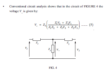

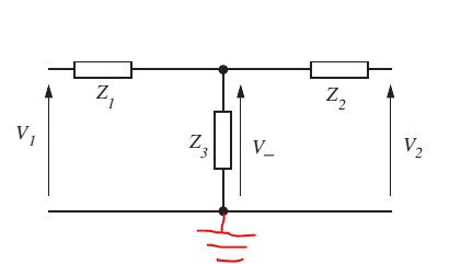

Circuit schematic labelled FIG. 4 showing impedances Z1 and Z2 in series across the top, Z3 in a shunt branch to ground, input V1 on the left, output V2 on the right and node voltage V- at the centre; equation (5) gives V- = Z3((Z1V2 + Z2V1)/(Z1Z2 + Z1Z3 + Z2Z3)).

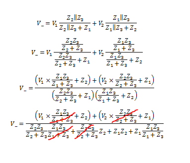

how did they get this ?? it is like a potential divider, can anyone explain...

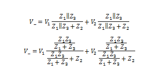

this is what i got[/B]
Equation: V_- = V1 Z2/(Z1||Z2) + V2 Z1||Z3/(Z1||Z3 + Z2), where || denotes parallel combination of impedances.

You can write the node voltage equations and rearrange them to get V_. There will be 3 principal nodes.Assume ground node at the bottom wire and proceed.
this is what i got
Your second term is correct involving V2, and if you had been consistent you'd have a corresponding correct expression involving V1. The method you are using for this is called Superposition.
so this
how can i rearrange this to equal this

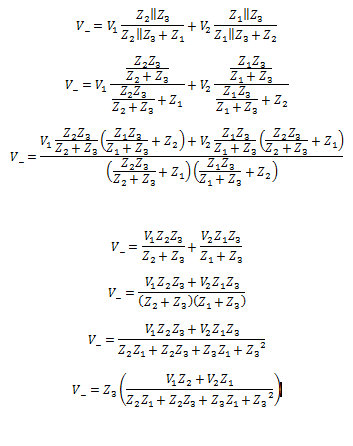

suv79 said:
Using cross multiplication, you will be able to cancel out Z2+Z3 in the denominator with that in the numerator. Then take Z3 common from the numerators and you are done.
when adding fractions why does the denominator for the Z1 Z2 become Z1*Z2 ?
suv79 said:
i don't really understand the last step here
How will you write this term in the denominator
Z1+Z2Z3/(Z2+Z3) using cross multiplication? It is used to make the denominators same. It is basic algebra.
e.g 3/4+2/3=[( 3×3)+(4×2)]/(3×4)=17/12.
You can not directly cancel the terms like you did there.
Two-line equation for V_ as V1 times Z2 Z3 over (Z2 parallel Z3 plus Z1), plus V2 times Z1 parallel Z3 over (Z1 parallel Z3 plus Z2), followed by a rewritten form with the parallel combinations expanded into fractions.
Consider only the first term i.e. the term before + sign. Apply the cross product rule in its denominator. What will you get?
Similarly proceed for the next term. It is a matter of only one step.

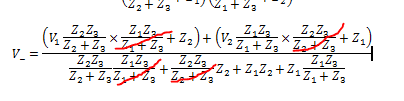

now i got this but still need to move Z3
  • Equation for V_ as a fraction: numerator (V1 Z2 + V2 Z1); denominator a complex fraction of (Z2 Z3)/(Z2 + Z3) + Z2 + Z1 Z2 + Z1 (Z3/(Z1 + Z3)).
suv79 said:
I think you are making it unnecessarily complicated. Just apply the cross multiplication rule to the denominator of each term separately. It is just one step and you'll be done.
Two-line handwritten-style derivation of V_ = V1 (Z2||Z3)/(Z2||Z3 + Z1) + V2 (Z1||Z3)/(Z1||Z3 + Z2), followed by a rewritten form V_ = V1 (Z2Z3/(Z2+Z3))/(Z2Z3/(Z2+Z3) + Z1) + V2 (Z1Z3/(Z1+Z3))/(Z1Z3/(Z1+Z3) + Z2), with parallel combinations written as fractions.
Two equations for V_ written as sums of two terms: V_ = V1 (Z2||Z3)/(Z2||Z3+Z1) + V2 (Z1||Z3)/(Z1||Z3+Z2), then rewritten with nested fractions in Z1, Z2 and Z3.
Let the two terms be A and B.
So, V_=A+B
(I can't use LaTex on my phone, so this is the best format I can write in..)
Denominator of A is Z1+(Z2Z3)/(Z2+Z3)
=[Z1.(Z2+Z3)+Z2.Z3]/(Z2+Z3)
=[z1z2+z2z3+z1z3]/(z2+z3)
This is the denominator of A. Now write A and see what you can cancel out. It is one of the basic algebraic manipulations.

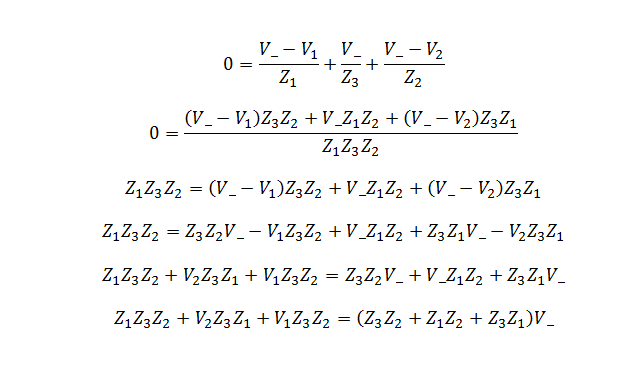

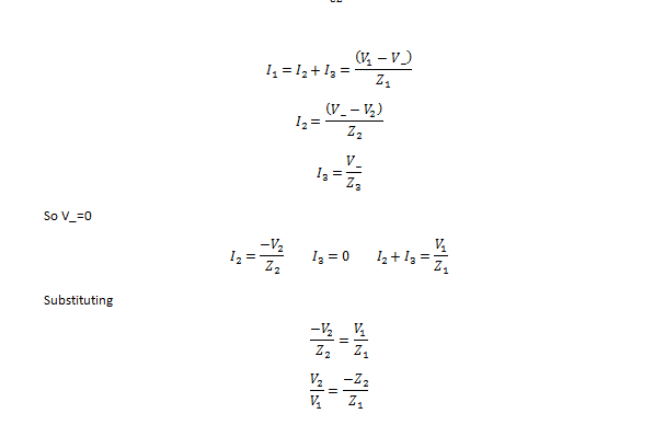

If I might make a suggestion? If you begin with a nodal equation at the junction the whole thing becomes much more straightforward.
suv79 said:
yes please :)
Um, that was my suggestion...

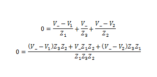

Have you been introduced to node voltage analysis ("nodal analysis") method yet?

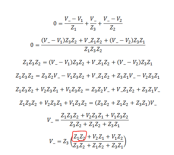

Good. Now since the whole thing is set equal to zero you can discard the denominator. With the numerator only now, expand the terms and then gather them by voltage variable. You should see daylight pretty quickly.
