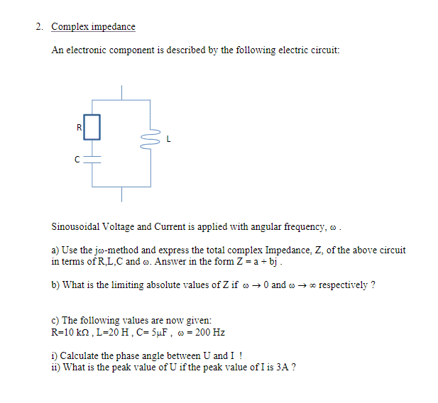

Can someone help me with what i do next
For part (a), what you have done so far looks correct. You should continue to simplify the expression (get it into a simpler fraction). I'm assuming you were asking about part a - if not, do correct me.
[EDIT]: you may want to 'rationalise' the denominators of the fractions to help reach the required form. If you are taking an AC circuit theory class, I am guessing that you have seen complex numbers before? If not, let me know and I can explain further/ point you towards some resources.

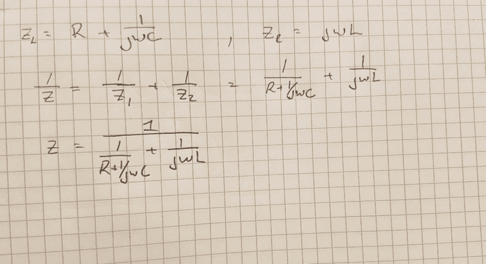

Generally, we know that two parallel impedances yield ## Z_{total} = Z_1 // Z_2 = \frac{Z_1 \cdot Z_2}{Z_1 + Z_2} ## which follows directly from the formula you wrote. It might be easier to write out the final impedance that way

1/Z_{total} = 1/Z_{1} + 1/Z{2} in parallel
NaS4 said:
I’ve seen it before. But there’s a lot happening here. And I don’t know where to start
Lets take ## Z_1 = R + \frac{1}{j\omega C} ## and ## Z_2 = j \omega L ##. The formula then becomes:
$$ Z_{total} = \frac{(R + \frac{1}{j\omega C}) \cdot ( j \omega L)}{( j \omega L) + (R + \frac{1}{j\omega C})} $$
Now you could multiply by, for example, ## j \omega C ## for the numerator and denominator. I don't think I can just give the answer

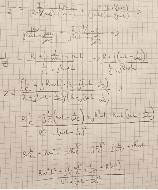

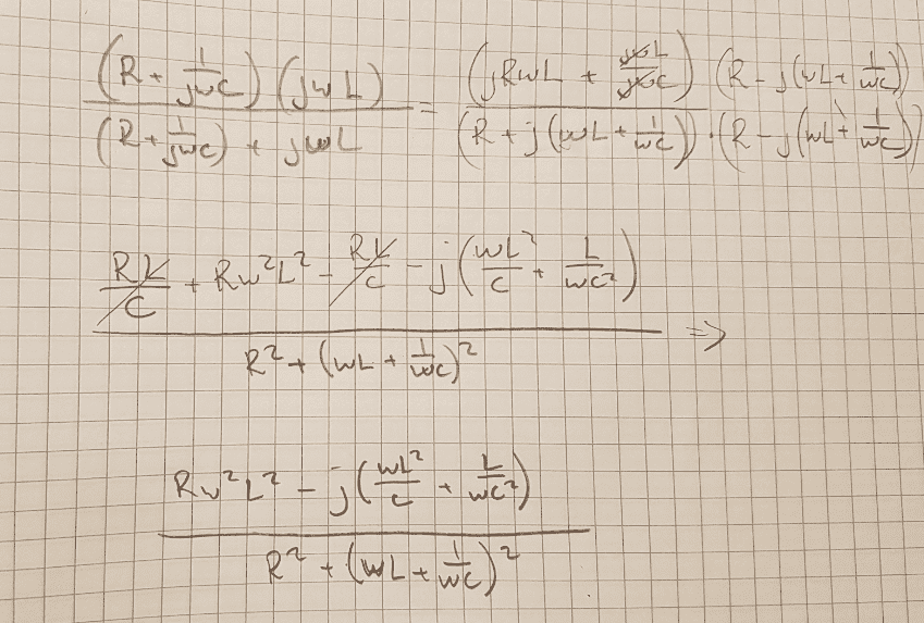

Is this correct?
NaS4 said:
Is this correct?
In the beginning, ## j \omega L + \frac{1}{j\omega C} \neq j(\omega L + \frac{1}{\omega C}) ## as the j in the denominator should make it negative (i.e. ## j(\omega L - \frac{1}{\omega C}) ##)
I think you might also be missing a term where ## j \omega L R ## multiplies the ## R ## in the first line
Ahh yes I see it
Damn so many mistakes. Thx man. I’ll change it and post my next try
NaS4 said:
@Master1022 How does this solution look?
That looks correct to me! It might be easier to turn the ## (\omega L - \frac{1}{\omega C}) ## into a ## 1 - \omega^2 LC ## term (remembering to multiply through by ## (\omega C)^2 ## ). This looks like it will be easier to work with for the next parts of the question.

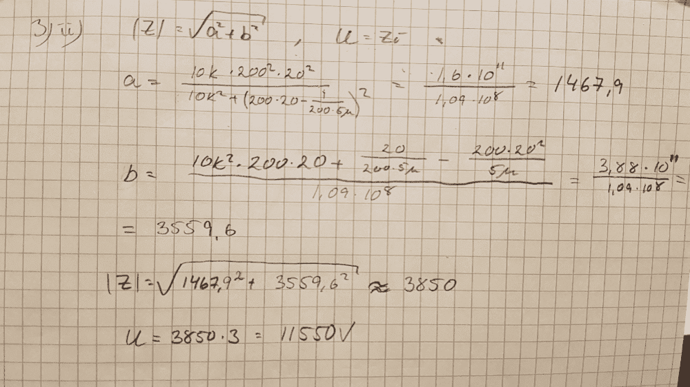

@Master1022 So I've done most of the tasks now. But I'm abit unsure of task c) ii)
That 11.5k V sounds abit to high 😅
What happened to the denominator in the expressions for ## a ## and ## b ##? I think you have forgotten those?
[EDIT]: I realized that you included them in the working, but not the initial expression. Please ignore the above statement.
That is true and does definitely stand out to me. However, this is what can happen in resonant circuits with very high Q-factors... I just did a quick calculation, and the number I got was slightly larger than your answer (but on the same order of magnitude). Maybe another member might notice an error that I have overlooked
Also, in the expression for ## b##, I think the central term in the numerator should have the ## C ## as ## C^2 ##. However, I am not sure whether that makes much difference given the order of magnitudes. I will go back to check the original expression to ensure that your formula is exactly the same as what I got
