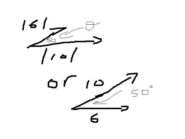

Vectors a and b have magnitudes 2 and 3. The angle between them is 50 degrees. Determine 5a - 2b and determine its magnitude and direction
Cosine Law and Sine Law
I can solve for the magnitude using the cos law and obtain an answer of 7.67 which is correct, however the direction and angle looks as if which vector i draw and where I draw it Heres a picture (The magnitudes I have just labelled as 10 which is 5a and 6 for 2b) :
Handwritten sketch of two vector diagrams with labels 16 and 10 (top, with angle 50° and 110 below) and 10 and 6 (bottom, with angle 50°), showing alternative arrangements of the vectors for the addition or subtraction problem.
Which drawing should I use, because It results in me getting different angles and direction
The most straightforward approach would be to pick one vector as the x axis, then break the other into its component, and add them that way.
