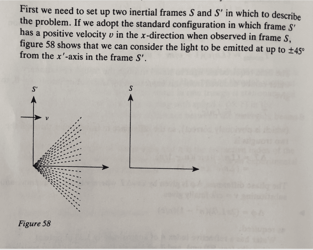

Visualising the problem (My question is with regards to this):
Why is the above set-up correct? In the above diagram, S would be moving at velocity -v relative to S', instead of v. Is this because the question says "speed v", and so we can set the direction as such? Why would the opposing direction of v be incorrect?

Yes, The rest frame of light is S'. But S is moving at speed v with respect to S'. In the diagram, it shows S moving at velocity -v with respect to S', why is it not correct to show S moving at velocity v with respect to S'? (which is the same as S' moving at -v with respect to S)
The diagram shows light source at rest in S' is approaching to S. it will come to origin of S and then surpass it and leave to infinite far away. In all the procedures light cone angle keeps 30 degree in S. So I think you do not have to keen on v or -v, approaching or leaving.

Why not S' move away from S (move in the other direction)? Where in the question says this cannot be the case?
Why don't you take v or -v as you like and solve the problem and then change the signature and solve it again?
Yes, it's because it says "speed" not "velocity".
You could, but you'd also have to change the relative positions of the origins of S and S' so that the observer at rest in S approaches the light source.
