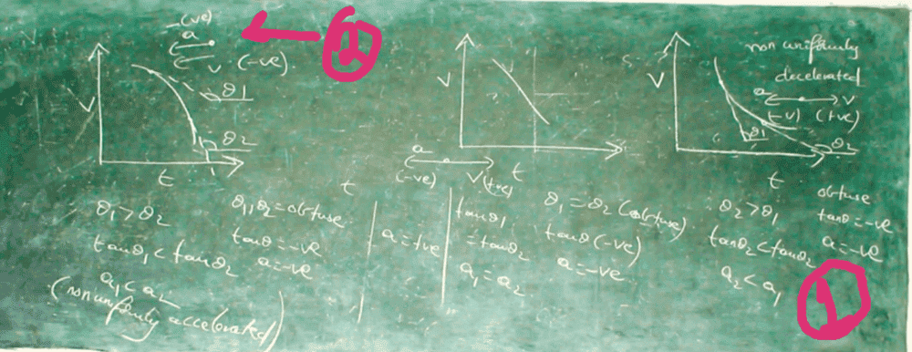

Paul_dirac
Why velocity in graph 1 is positive and in graph 2 is negative?
a=dv/dt
Who says it's negative on graph 2?
Could it be that you intended to ask about acceleration?
I don't think so. The acceleration is negative in all three plots.
