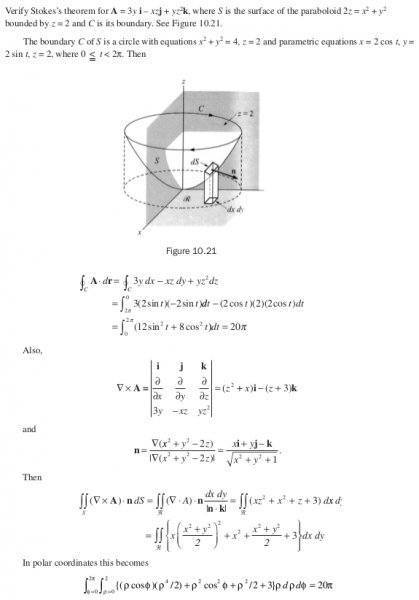

Verify Stoke's theorem for this surface
  • Thread starter Thread starter s3a
    Surface Theorem
s3a
814
The problem and its solution are attached in TheProblemAndSolution.jpg.
Stoke's theorem: ∮_C F ⋅ dr = ∮_C (FT^) dS = ∫∫_S (curl F) ⋅ n^ dS
In the solution attached in the TheProblemAndSolution.jpg file, I don't understand what's going on with the integral that has |n^k^| on a denominator.
Could someone please add the steps that are skipped by the solution?
An easier way would be to say:
$$\oint_C \vec F \cdot d \vec r = \iint_S \text{curl}(\vec F) \cdot d \vec S = \iint_D \left[(z^2 + x) \hat i - (z+3) \hat k \right] \cdot (\vec r_x \times \vec r_y) \space dA = \iint_D \left[(4 + x) \hat i - 5 \hat k \right] \cdot (\vec r_x \times \vec r_y) \space dA$$
Where ##\vec r(x,y) = x \hat i + y \hat j + 2 \hat k##.
A simple switch to polar co-ordinates afterwards would clean that up nicely.
