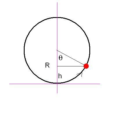

And considering the circle rotates counterclockwise and at 2∏/3 radians tangential acceleration exists again(parallel to velocity, so it accelerates) , is it really possible for the object to only rotate to 2∏/3?
The particle moves along the circle. See picture. The height from the lowest point is h=R(1-cos(θ)) .
It does not matter if theta is measured clockwise or anti-clockwise as cosine is even function.
ehild

Oh yes sorry my mistake we have to use cos indeed. Another question if you don't mind, will this initial velocity depend on the tension of the string?
The initial velocity is given. The tension of the string depends on the speed. It has to provide the necessary centripetal force together with the radial component of the weight.
