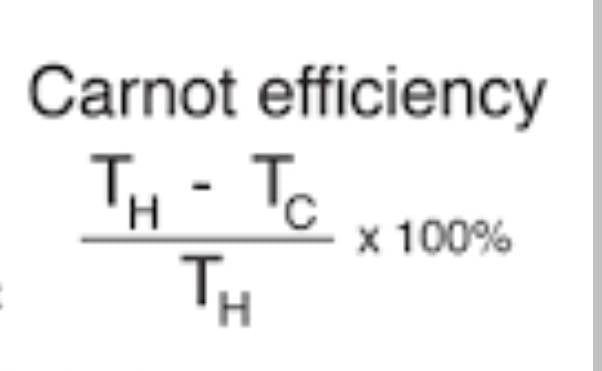

This is a better equation I found. Sorry I should have taken a picture instead.
What I did was to plug in 100 on "TH" variable and the -5 K on the "TC" variable. I got an efficiency bigger than 100%. Would that make it violate the 2nd law that states that a system cant have 100% efficiency?
In a previous post, I mentioned an implicit assumption that you are making: You are assuming that 100 degrees is hotter than -5 degrees.
"Hotter" in thermodynamics has a technical meaning -- heat will flow spontaneously from the "hotter" reservoir to the "colder" reservoir.
Negative temperatures (which are indeed possible) are hotter than all positive temperatures. The thermodynamic definition of temperature is weird and arguably backward. Reciprocal temperatures behave more sensibly in this regard.
