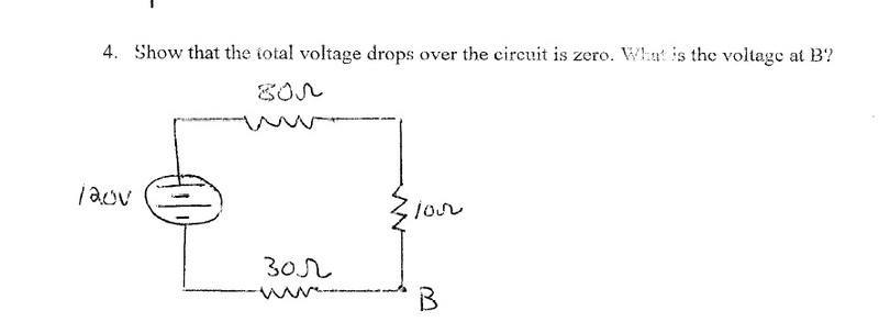

Show that the voltage drops over the circuit is 0. What is the voltage at B?
I = E/Req
120V/120ohms = 1 A
120V - (80*1) - (10*1)- (30*1) = 0
120 - 80 - 10 = 30V at B
I have nooo idea about the B part... can someone please verify!
THANKS!

You seem to have done all right.
The question is a bit sloppy though: they should have specified a point of reference when they asked about the voltage at node B. The default assumption in this case is to reference the "-" terminal of the supply.
So in my understanding the current is flowing clockwise... is that a correct assumption?
The battery symbol in the schematic implies that it is "+" on top, so yes, conventional current flow would be clockwise in the circuit.
