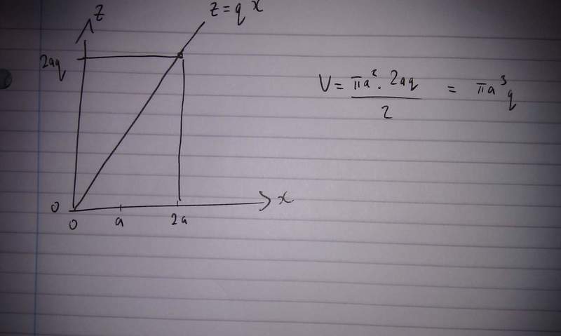

Find the volume of the enclosed by the surfaces [tex]z=qx[/tex] [tex]z=0[/tex] and [tex]x²+y²=2ax[/tex]
This is meant to be done with calculus but can verify my answer with simple geometry - should be [tex]\pi a^3q[/tex]
So the top of the wedge will be when [tex]x=2a[/tex]
Form rectangular slices of the wedge perpendicular to the x-axis with area [tex]A=2yz=2\sqrt{x(2a-x)}qx[/tex] and volume [tex]2\sqrt{x(2a-x)}qx .dx[/tex]
Then integrate this from x=0 to x=2a gives:
V=[itex]\int ^{2a} _{0} 2q \sqrt{x^{3}(2a-x)} dx[/itex]
I've checked this numerically with wolfram alpha for certain values of a and q but I haven't got a clue how to evaluate it.. the question said to use a double integral but I don't know what a suitable double integral would be...

So the cylinder has radius a and touches x=0 and x=2a
The cylinder goes up to a height of z=qx=2aq
So the total volume of the cylinder is [tex]\pi a^{2} * 2aq = 2 \pi a^{3} q[/tex]
So the volume of the half of the cylinder we're interested in is half that [tex]V=\pi a^3 q[/tex]
Am I doing something wrong?
You need to divide your answer by 2 again. Why?
1. You are dealing with half of a cylinder (vertically split in half).
2. You are dealing with a wedge in the cylinder (diagonally split in half).

I'm dealing with an entire cylinder split in two. The equation is x²+y²=2ax (equivalent ton (x-a)²+y²=a²) not x²+y²=a².

I have drawn it on paper as you would in the exams. I suggested using a graphing software to help you to visualize it in 3D.
Here is the double integral (using polar coordinates):
[tex]\int^{\theta = \frac{\pi}{2}}_{\theta = 0} \int^{r=2a\cos \theta}_{r=0} \left[ z \right]^{qr\cos \theta}_0\,.rdrd\theta[/tex]
