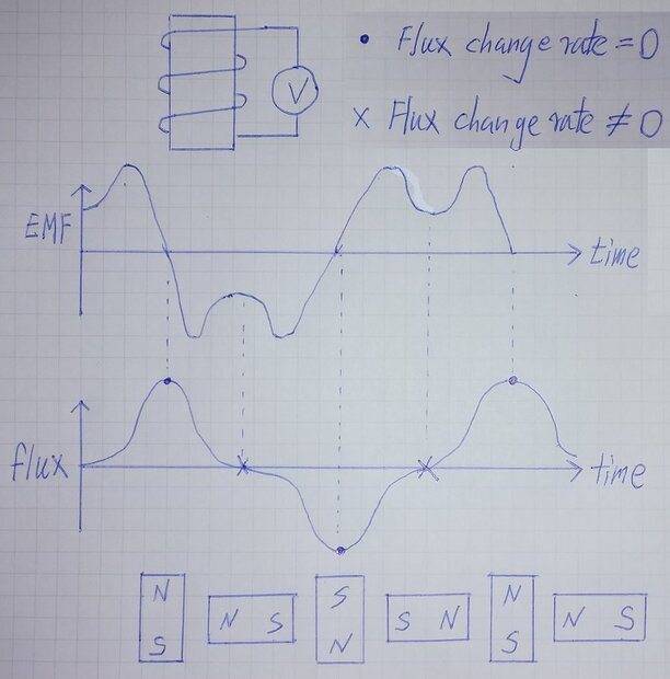

In this type of arrangement is induced emf influenced by flux cutting also or only rate of change of flux linkage?
  • #62
It is rate of change of flux linkage.
Draw the magnetic field of your magnet.
Draw a circle about the mid-point of the magnet with a radius equel to the distance to the coil.
Plot the rate of change of line density crossing that circle, around the circle, to get the induced voltage.

I understand but aren't the side conductors of the coil also getting cut by the non uniform flux density sweeping across it and as a result also contributing to induced emf quantities? Just a thought.
  • #64
It is the rate of change of the number of lines passing through the area of the coil. It has little to do with bits of wire, it is all to do with an area.

So if I may presume, as a hypothetical case for that matter, the side conductors of the coil are of significant length. Will the flux cutting have any considerable influence on the induced emf in this case?
  • #66
The area of the coil is defined by the wire. If a line of flux enters that area, at the same time as another line of flux exits the area, then no voltage will be generated.
You must forget about the local wire and see only the area of the coil defined by the windings.

The equations for faraday's laws of EM are common to both methods of induced emf (rate of change of flux linkage as well as flux cutting). I was wondering if there was a way to distinguish between the two in the rotating magnet case.
  • #80
There is really only one method of calculating EMF and that's the rate of change of flux. What you refer as flux cutting I interpreted it as calculating integrals that contain ##\mathbf{B}\times \mathbf{v}## and is suitable for systems that contain moving wires with velocity ##\mathbf{v}##. But this method is equivalent to the rate of change of flux method.
Here in this example in the rest frame of the rotating magnet the wire of the coil is moving, so you can use the second method but its going to be a hell of more complicated.

I believe that Faraday's law applies to all situations, for example, the magnet is stationary and the coil is moving, or the coil is stationary and the magnet is moving, or both the coil and the magnet are moving, or the mutual inductance of the two coils that move relative to each other, or others. :smile:
  • #84
Absolutely. But in this particular case the contention was which method is best applicable (or both) to the rotating magnet case.
From the arrangement it implies that two situations are applicable to this case;
1) 'Statically' induced emf due to rate of change of flux linkage with coil (transformer simulation)
2) 'Dynamically' induced emf due to cutting of magnetic flux lines by side conductors of the coil as a non uniform magnetic field sweeps across the coil (dynamo simulation)
I believe the above 2 types of EM induction would give rise to individual emfs which may contribute as a whole to the total induced emf value in the coil at a particular instant.

If this is a permanent magnet, so the strength of the magnetic field source itself does not change, then this should be a motion-induced electromotive force. You can use the Lorentz force (the cutting of the magnetic field) or the change in the magnetic flux through the coil to calculate the induced voltage. Both methods should get the same answer, but I don't think the two methods should be used at the same time. As for the method to be used, it depends on the actual situation and each person's choice.
For the example you put forward in #1, because the magnetic field generated by the magnet is very uneven in space, when the magnet rotates, the relative angle of the coil and the magnet is constantly changing, so no matter which method is used, I believe that manually calculating the actual induced voltage is very difficult.
  • #86
All changes in flux through the coil will result in "cutting" of flux lines. Either the lines move apart or the coil moves to a region of different line density. The results comport with Faraday's Law in either case.
But you cannot calculate a result by endlessly using semantics. Set up a model and calculate.
Edit: I recommend a program called Vizimag which I have used and offers a free 30 day trial I believe. This problem is inherently a 2D problem. Print out some fields (you can choose the line value) and look at how the fields and line cuttings behave. I think your intuition has been pretty good here.
You need to think about line cuttings and line "uncuttings" as well. It is the net change that matters for a loop.

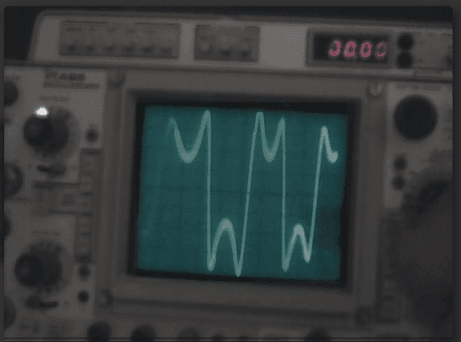

Suggest you try the experiment if you have access to an oscilloscope. You could spin a cylindrical magnet that is about 10 cm long with an area of 1.0 cm^2. Just some ballpark numbers: The magnetic field at the endface ## B \approx 1.0 ## W/m^2, so that the flux ## \Phi \approx 1.0 ##E-4 . It should be easy to achieve a ## \Delta t=.1 ## seconds for a half cycle. With ##N=10 ## turns, and assuming the entire flux goes through the coils, you get an EMF ## \mathcal{E}=10 ## mV. I think you are correct when you stated previously that the sinusoid will be distorted with a double "up" hump, and a double "down" hump.
Notice also, to get a stronger signal, you can spin the magnet faster.

Post #29 specified the dimensions, but not the number of turns on the coil.
  • #89
No I don't, that's why put query on forum.
  • #90
I presently don't have access to an oscilloscope either. It would be interesting to see some experimental results.
