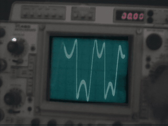

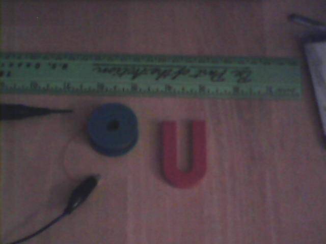

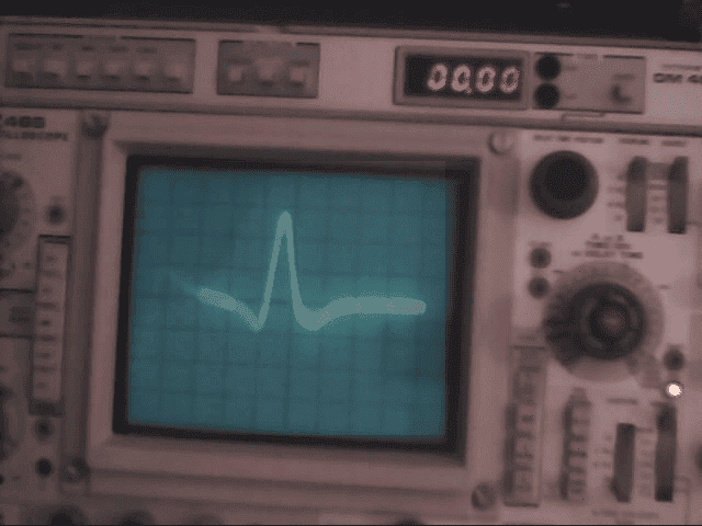

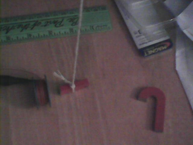

Well, I finally ran the experiment.
The hardest part was finding a bar magnet on short notice. Actually I never did find one locally, I did find a horseshoe magnet so I ran two experiments, one with the horseshoe and one with a bar (obtained by sacrificing the horseshoe).
The coil is a spool of 30 AWG wirewrap wire I had around (no idea how many turns, many) and the oscilloscope is a Tektronix 465.
The test with the U (horseshoe) magnet was done by hand-holding the magnet and sweeping it across the diameter of the coil
The string tied around the center of the bar magnet was used for suspension and twisted to supply spin to the magnet upon release. Magnet was approximately on the coil axis.
The funny 'scope traces are because they are a composite of video frames taken with a bargain-store pocket video camera that is many years old.

  • Photo of a blue wire spool coil, a red horseshoe magnet and a ruler on a wooden surface, with two black test leads visible at the left and bottom.
  • Oscilloscope screen showing a single sharp voltage spike with a smaller dip after it, a classic induction pulse waveform, on a blue-green grid display.
  • Photo of a bar magnet hanging by a string above a red-painted wooden block beside a red horseshoe magnet on a table, with a coil of wire and a green ruler visible.
  • Photo of a Tektronix 465 oscilloscope screen showing a distorted, wavy trace with several sharp peaks and troughs, captured from a video frame.

Thank you very much for sharing the results of your experiment.
I think the result of Bar-composite.png seems similar to my previous prediction of induced voltage waveform.
My prediction is ## ~+A→-A→0→-A→+A##
But it is actually ##~+A~→0→-A→-A→0→+A##

Actually the prevailing opinion here is that we will have two positive humps and two negative humps with some zero inbetween
but
if I interpret the oscilloscope screens correct (I am not EE so I don't have experience of working with an oscilloscope) I think we have two positive humps (local maximums) with another positive reversed hump in between (local minimum) and two negative humps with another negative reversed hump in between.
We missed this extra reversed hump..

The experimental results almost matches the theoretical assumptions related to this arrangement. However, the only contradiction to the assumption is the continuity of the double peaks. In my opinion it should have gone to 0 between the double peaks as below;
0 +A 0 -A 0 -A 0 +A 0 +A 0 -A 0 -A 0 +A and so on...
I wonder why there was no 0 state instead of continuous v curves in between the double peaks.
