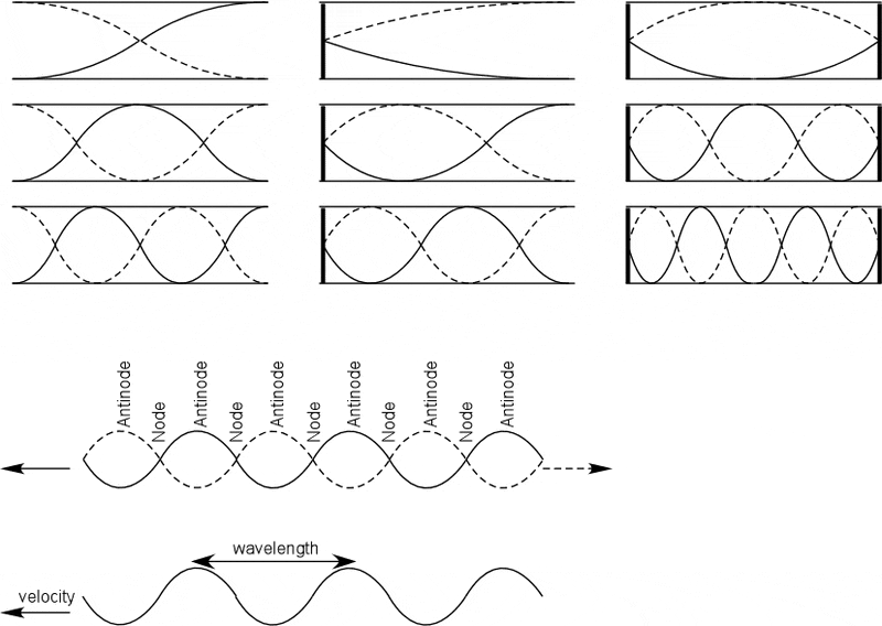

A room is 4m wide in the x direction, ignore the y and z directions. Compute the longest sound wave that can occur in the room and its frequency.
speed of sound = 350 m/s
λ = speed/frequency
Since the room is 4m wide and sound is a stationary wave, the longest wavelength that can occur is 4m.
λ = 4m
frequency = speed/λ = 350/4 = 87.5 Hz
This just seems incredibly simple, is there anything I'm missing?

Yeah, there is. Consider by analogy standing waves (what you call stationary waves) on a string. The string is fixed at both ends. You can have a standing wave where the whole string just oscillates up and down. So there is just one node in the middle, and two anti-nodes at the ends. Or maybe it's the other way around, I forget the terminology. But the point is, there's one point in the middle with max transverse displacement, and two points at the ends with zero displacment. What is the wavelength of this wave, relative to the string length L?

For the case of the string, when m = 1, you are right that λ = 2L = 8 m. If you think about it, when the whole string is vibrating up and down, this corresponds to one peak or one trough. So the answer is, a whole wavelength doesn't fit on the string in that scenario. The string is half a wavelength. It's like in this figure, right-most column, the top diagram of the three:
For the case of a sound wave, I'm still struggling with my intuition as to how that's possible. I would think that the rightmost column, middle diagram would be the shortest sound wave you could fit, since if the pressure and density are peaked in the middle, they must necessarily be lower on either side...
Now I think I get it. You have to be careful when talking about longitudinal waves to distinguish between talking about the displacement of the air and the pressure of the air, which are out of phase with each other. For a closed room (fixed boundary conditions) the edges are displacement nodes (because air there can't go anywhere), but pressure antinodes, (because the pressure at the ends varies between maximum and minimum as air coming in from the centre of the room piles up at the edges and then "unpiles"). Likewise, in the centre, there is a displacement antinode (because air moves the most there) but a pressure node (because it all moves by the same amount, so there is no pile up in the centre, unlike at the ends). So we have this slinky effect, oscillating between this:

In the first figure, maximum rightward displacement of centre air corresponds to the upward "peak" in the m = 1 diagram above. In the second figure maximum leftward displacement of centre air corresponds to the downward "trough" in the m = 1 diagram above
The distance between nodes or antinodes is half a wavelength, and since we have nodes at the ends of the room (just like for the string with fixed ends) the answer is again λ/2 = L.

Again, like I said before for the string, all it means is that you only fit half a wave on the string, or in the room. (see attached)
There's no reason why you can't have an EM wave of wavelength λ = 2L in a resonant cavity of length L. It just means you have only half a wave in the cavity (again, see attached)
