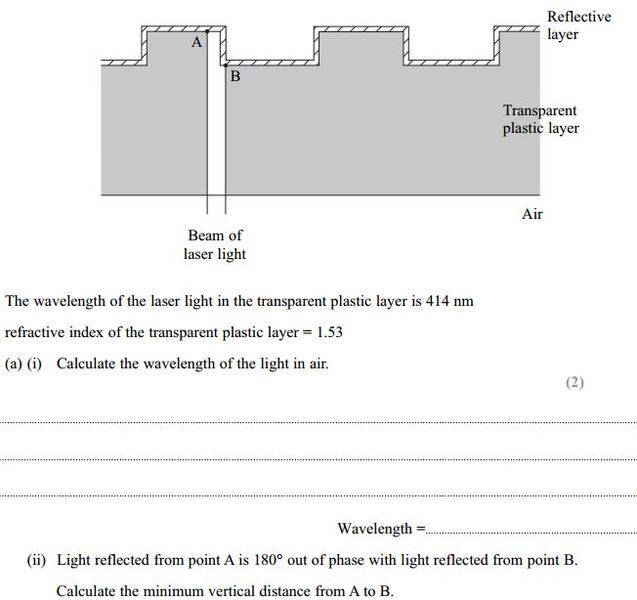

For the first part I know the wavelength of light is (1.53 x 414nm) = 633nm
But for the second part I'm stumped. Since it's 180 degrees then the waves are in antiphase but I don't understand how to calculate the vertical distance?? (If antiphase then the path difference is (n+0.5)(lambda) )

Waves going to A and getting reflected there to get back to the emitter take a longer path than waves getting reflected at B. How much longer?

Since it's 180 degrees out of phase then that means it's half a wavelength behind so n would be 0.5, right?
n is always an integer. the "0.5" are added to n already.
Person X and Y both start at the same place. Person X goes to point B and back to the start. Person Y goes to point A, which is a distance d behind point B, and then goes back to the start. What is the difference in the path lengths of person X and Y?
The difference from above is equal to (n+0.5)(lambda) for some integern n. Which integer n leads to the smallest distance d?

Dude, that's the answer.

P.s. Don't forget that the light reflected from A covers the distance between A and B twice.
