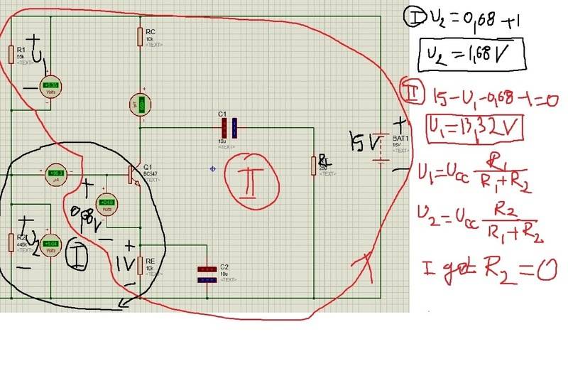

I got a new task from my professor:
Compile common emmiter amplifier(NPN) with the following default parameters:
VCC = 12V, power transistor 50 mW max. output signal between 3-5V, VRE = 1V.
Determine Computing and measuring AV, AI, Rin, Rout, the upper and lower limit frequency, THD.
Then, instead of RL connect the speaker and try something heard on the speaker.
I have choosen transistor BC547.
I assumed that the voltage at RL is 5V and from PRL=VRL^2 / RT I get that RL=250 ohms.I measured that Vbe=0.68V.
I am trying to figure out what should be resitances R1 and R2

R1 and R2 are chosen to give you the required 1V at the emitter. Consider the base dc current also.
The professor meant to limit your dissipation to 50 mW, not that the transistor cannot sustain more than 50 mW, probably.
EDIT:
I didn't see the 1V VRE requirement. So this will not be a real common-emitter circuit.
What are your upper and lower frequencis?
You can probably connect the speaker in series with the collector resistor.

The specs say Vcc = 12V, yet your calculations use Vcc of 15V. Why? :oldconfused:
My bad I was really tired at evening when doing this that I didn't even notice it was 15 V.
How do you mean it won't be real common emitter circuit when it has a resistor RC connected directly to the collector electrode?R1 and R2 are voltage dividers I know that they are used to set Quiescent Point.If R1 and R2 are voltage dividers of Vcc and if I want 13.35 V at R1 and 1.65 V at R2,R1 should be 8.09 times larger than R2.

If you're aiming for 50mW dissipation, and you bias for VCE of around 6-7V, then what will be the DC value of IC?
Well I don't know since I am trying to figure out how to find R1 and R2 since they determine the bias IB and then IC.If I assume that Vce is around 6 V then VRC=VCC-VCE-VRE=12-1-6= 5 V but still I don't know the value of the resistance RC?
power dissipation = voltage x current
- which voltage?
- which current?
Remember that power into the base is a negligible fraction of total power, for these small signal amplifiers.
