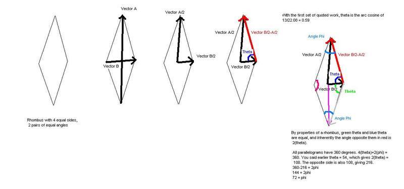

For #2, remember that vectors A and B and the adjoining vector C represent one quarter of the rhombus. A diagonal stretches across half of a rhombus, before you subtract the two vectors and dot them, you need to half them.
a dot c
\hat a = 3/2\hat i - 2\hat j - 1/2\hat k with Magnitude: \sqrt{3/2^2+(-2)^2+(-1/2)^2} = \sqrt{9/4+4+1/4} = \sqrt{13/2}
\hat c = 1/2\hat i - 7/2\hat j + 5/2\hat k with Magnitude \sqrt{1^2+(-7)^2+5^2} = 5\sqrt3
a \bullet c = ((3)(1) + (-4)(-7) + (-1)(5))(1/2) = (1/2)(3 + 28 -5) = 13
cos(\theta) = \frac{a\bullet c}{|A||B|} = \frac{13}{5\sqrt{39/2}} = 0.59

how did you get cos(\theta) = 0.59 i tried it and got 0.83.. and using either 0.83 or 0.59 .. I am still getting the wrong answer for \Theta(34 or 54):frown: i think the answer in the back of the book might be wrong
Whats the answer in the book?
72 degrees and 108 degrees
Its easier to draw than to explain, but this should be easy to understand.
Let it serve as a reminder to all of us that drawing an example always helps.
