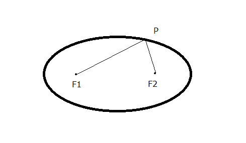

Here is a picture of what jedishrfu is talking about. The foci (plural of focus) are at F1and F2 and P is an arbitrary point on the ellipse. For an ellipse, the sum of the lengths of the segments F1P and PF2 is a constant. As we move around the ellipse to the right, the segment F1P gets longer and the segement PF2 gets shorter, but the sum F1P + PF2 remains the same.
If you move one or both of the thumbtacks, which changes the location of the foci, you get a different ellipse.

Your sentence above is very confused, as it implies that "the foci" is the locus of some points. That's not true.
You hold the string taut and the string does not stretch then the pencil will draw the ellipse correctly. Notice at each point on the ellipse, the string makes a triangle with corners being the pencil point and the two thumb tacks, and for each of these triangles the triangle perimeter is always the same length.

Thanks a lot. That is as simple as it can get. I get the point.
