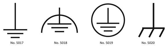

Now for ground symbols. See https://www.clarionsafety.com/content/Featured_Articles/InCompliance-January-2012-Grounding-Symbols.pdf
The actual symbols used to indicate ground terminals are found in IEC 60417
Graphical symbols for use on equipment
