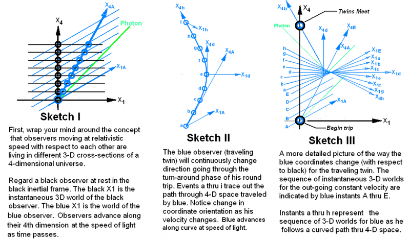

vraeleragon, it's really not very complicated conceptually. I've prepared a set of sketches to help you visualize what is going on in the 4-dimensional universe with the twins. As the traveling twin changes velocity, his X1 axis continuously rotates such that the photon world line always bisects the angle between his blue X4 and blue X1 axes. These are what we refer to as a continuous sequence of boosts. The Lorentz transformations describe the boosts mathematicially. If you need a little more background on the space-time sketches and the 4-dimensional universe concept, you can go to this earlier post that outlines the concept, beginning with post #19 (be sure you understand relativity of simultaneity--if not ask questions):

Very nice observation. And it is clear that it is the difference between the paths taken through the 4-D universe that accounts for the difference in ages when the twins meet.

Spot on, Bob!

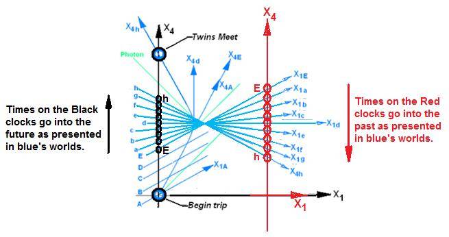

Bob, you will love this one:
It's a bit off-topic here but there's some interesting feature happening with this 3Dworld rotation;
Add a third 'observer' (let's make him red) in your sketch with a world line parallell to the black one. Right of where the blue turns around.
For blue, in the successive blue worlds, red's clock runs... backwards! And then -once inertial again - forward again (again over the red clock events his 3D spaces went over already!)
But blue observer will not literally SEE this. When you draw the lightbeams from the red clock events you will notice that blue observer will never litterally SEE the red clock going backwards.
The interesting question is whether the clock 'really' runs backwards. Of course it does in the successive 3D worlds, but the question and answer only make sense if we agree on the ontological definition of a 3D world, i.e. space-like simultaneous events. This is a dicy topic on this forum, where most members prefer to stick to the mathematics. But I always keep Richard Feynman's words in mind, and will keep on repeating it: <<... Physics is not mathematics, and mathematics is not physics. One helps the other. But you have to have some understanding of the connection of the words with the real world. ...>>
(minute 45:43 in http://www.youtube.com/watch?feature=pl ... d0xTfdt6qw)
The 'real world' is nothing else than Special Relativity's Minkoswki 4D manifold as one physical block entity. We then know that the ticking of the clock -'backward' or 'forward'- is nothing else than reading 'observer independent' timeless clock events that are located in 4D block Spacetime.

That was a great reference, DaleSpam. Vandam, here's a rendition about what you were suggesting. I've added in a Red guy as you suggested. He is at rest along with the black guy. As the Blue guy does his turn-around, the sequence of Black clock readings (as presented in the sequence of Blue's 3-D world cross-sections of the 4-D universe) progress into the future whereas the Red clock readings proceed into the past. As Blue enters the turn-around, the Black clock begins with event "black E" and at the end of the turn-around the last Black clock reading corresponds to event "black h." But, although Red's clocks begin with event "red E" (same simultaneous plane as "Black E") and end with event "red h", we see the sequence of Red clock readings going into the past along Red's X4 axis world line. The E, a, b, c, ... h designations identify the discrete hyperplanes (planes of simultaneity) in the movement through 4-D Space-Time of Blue as he progresses along his world line.
