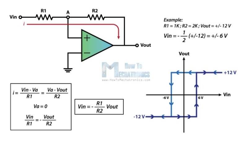

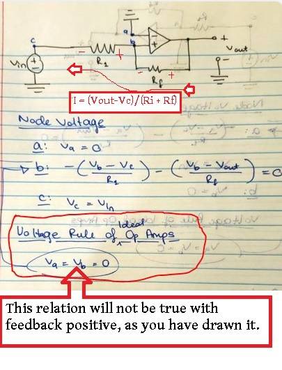

  • #31
Abdullah Almosalami said:
I could have gone wrong in the calculations, but I don't see it and no one has pointed out where,
Actually, previous posters have pointed out where you went wrong but perhaps they were too subtle for you and their message has been lost in the formulas. So, here's the fundamental point you have missed: what you labelled as the "Voltage Rule of Ideal Op-Amps", Va = Vb, in the first diagram in post #1 IS ONLY VALID FOR NEGATIVE FEEDBACK AMPLIFIERS.
The feedback in a negative feedback amplifier acts to drive Va (in your circuit) to be equal to Vb. In a positive feedback amplifier the feedback acts to drive Va away from Vb. Hence Va is not equal to Vb in a positive feedback amplifier. The Voltage Rule is not valid for a positive feedback amplifier and you cannot use it to analyse a positive feedback amplifier.
The problem with your analysis in the second part of post #1 and in post #13 is that you have still included your Voltage Rule; the assumption that Va = Vb, in your analysis . That is why your analysis gives you the results you know to be wrong.
To analyse the positive feedback rule you'll need to use the formula gneill gave you in post #2: Vout = A(V+ - V-).
Note that putting the wrong formulas into a simulation will produce the wrong outputs, even if it does look very neat.
EE textbooks (like the two I've looked at) derive the equations for the standard inverting input case but always ignore the other way around.
The standard equations are only valid for negative feedback circuits. There is no corresponding equation for a positive feedback amplifier because no corresponding positive feedback amplifier circuit exists. (You should however find an equation for a non-inverting negative feedback amplifier.)
Other posters have pointed out that an op-amp circuit with positive feedback gives you a comparator circuit with hysteresis, also known as a Schmitt trigger circuit. You may find an analysis of this circuit in your textbooks, or online.
What I was kind of hoping for was for someone to describe a more accurate model of an op amp that does account for all that was mentioned here.
You don't need a more accurate op amp model for this analysis. The introductory model is fine as long as you realize why your 'voltage rule of ideal op-amps' applies only to negative feedback circuits.
If you go back and re-read the thread, bearing in mind that your Voltage Rule is only valid for negative feedback amplifiers, you should find that the early posts do actually say this.

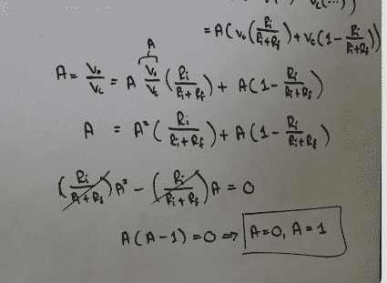

  • #36

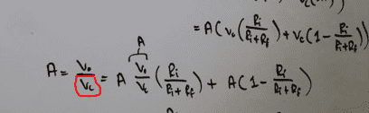

jim hardy said:
Va = 0
and Vb = Vc + (Vout - Vc) X Ri/(Ri + Rf)
Vout = Avol X (Vb - 0)
Vout = Avol X (Vc + (Vout - Vc) X Ri/(Ri + Rf))
Gain = Vout/Vc = Avol X (1 + (Vout/Vc -1) X Ri/(Ri + Rf))
looks recursive to me. Check my algebra ?
old jim
My point was not that my assumptions were correct, but that the math itself was not wrong, as in there were no algebraic errors.
On your equations, how come you can use voltage division like that? If we can't assume that no current is flowing into the positive input of the op amp, then Ri and Rf are not necessarily in series, and so the voltage division formula doesn't work, right? And so, your equations here are based on the ideal rules.
But even if it were true, then continuing your math, this is what I get:
I'm not sure what the solution to A over here means, and how there can be 2 different amplifications, so perhaps this is a paradox because of some wrong assumptions, given I didn't make algebraic errors.

  • #38
yes, i used ideal rules...
Your algebra is so good it intimidates me, to be honest. I've not worked through it yet - you only posted it a moment ago.
I had prior knowledge that this circuit is bistable so had hoped my algebra would arrive at a quadratic so there'd be two solutions
but i didn't find one
but my algebra is notoriously strained, I'm math challenged and make dumb mistakes.

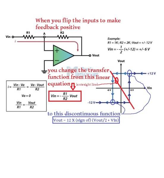

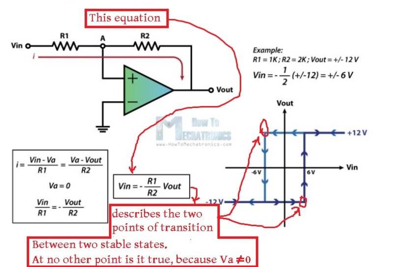

meantime, see what you think of post # 35 where i tried to explain how to work the circuit in one's head.
That is a necessary thought step so we use our math correctly.
Previous posters have tried to explain that the circuit is not stable, ie the math it performs is not a linear multiplication.
So the algebraic expression Vout = VinX(-10) describes not its transfer function but the cusp on which it teeters.
I am just now getting that. Was working my way down, and replying as I went along, so if I had missed an important point in that post, my bad!
jim hardy said:
The first accidental millivolt (of either polarity )that appears on Vout will be coupled, attenuated elevenfold, to the +input
which will drive Vout in the same direction , and a lot further because of gain
then get coupled back again to + input
causing runaway in that direction..
That's what positive feedback does.
The output will drive to the amplifier's capability and remain there.
So the circuit is not stable as algebra implies.
Nor is it astable as intuition implies
It's bistable, will sit happily at one limit or the other until you apply enough Vin to overwhelm the feedback and make it flip to the other state.
As has been mentioned already, it's the well known Schmitt Trigger and Rin / Rfb sets the hysteresis.
old jim
Ok just read through it. And yes. Actually, even though I kind of got that positive feedback in general in any system would make things unstable, until you mentioned it here and put it into words, I didn't fully realize it, so thanks for that Jim. And I see! The bistable points A=0, and 1 are the stable points because a gain that is not either value would cause the output to go exponential! I suppose however that gains between 0 and 1 would cause the output to exponentially decay to 0, which is still stable (but not useful?), and it is the gains that are greater than 1 that would cause the unstable exponential growth. And actually, going back through the posts, I just now understood what this post was saying:
LvW said:
Yes - of course. A slight positive feedback will result in a stable amplifier (with reduced bandwidth) - as long as the loop gain is <+1.
However, it was my intention not to complicate the answer to the given problem and to be realistic - because the amount of positive feedback for the circuit under discussion is required to be smaller than 1/Aol (Aol=DC open-loop gain) for a stable bias point.
And indeed I haven't yet come across the Schmitt Trigger circuit, and I'm sure I'll have a much better perspective once I get around to studying that.

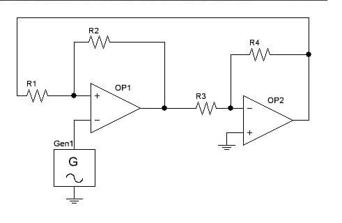

Question: For the purpose of finding the gain formula for the attached circuit - is it allowed to set Vp=Vn [or (Vp-Vn)=Vout/Aol] for the most left amplifiier ?
The relation Vout = A(v+ - v-) is incomplete, it's a simplification. There are strong conditionals attached to it restricting it to only those instances where Vout is not pinned near either rail.
A more complete representation would be Vout = A(v+ - v-) iff (Vo max> Vout > Vo min)
So before applying that simplified rule, you must first establish that Vout is going to lie within the allowable range, and if it doesn't then that rule doesn't apply.
-edited-

  • #46
LvW said:
Question: For the purpose of finding the gain formula for the shown circuit -is it allowed to set Vp=Vn for the most left amplifiier?
My old adage:
"Ir is the duty of the operational amplifier circuit designer to wrap his amplifier with a circuit that allows the amplifier to drive its inputs equal,
else his operational amplifier circuit cannot perform the desired operation."
So yes, that is what you should do.

  • #47
A more complete representation would be Vout = A(v+ - v-) iff (Vo max< Vout > Vo min)
Yes, of course, though I think one of your comparison signs needs turning round:
(Vo max > Vout > Vo min)
This applies to both positive and negative feedback circuits, though the output will be clipped less often in a negative feedback circuit (because operation will be in the linear region as long as the circuit isn't overloaded.)
  • #48
I think, such a "rule" is self-evident as it applies to all amplifiers - not only opamps.
  • #49
Evidently not so self-evident, as OP is applying it where it is not applicable—in his positive f/b circuit.
  • #50
Indeed, it does need fixing. Thanks.
There is an algebra error. The fourth step from the bottom uses the substitution Vo=A(Vc) but the correct substitution is Vo=A(Vb), defined in your step 3. (Assuming I am reading your handwriting correctly that this. The subscripts are a bit small on my screen.)
This circuit can be perfectly stable.
The correct way to analyze the operating point is KCL at B. (b-c)/Ri = (o-b)/Rf substitute b=o/A and solve yielding o=A*c*Rf/(Rf+Ri-A*Ri) (thanks wolfram alpha!) As lim A->inf you get Vo=-c*Rf/Ri which is the correct answer.
Spot check in spice if you like. A=10, c=1, Ri=Rf=1K and alpha says Vo=-5/4V
% cat amp.sp
E1 o 0 b 0 10
V1 c 0 1
R1 b c 1K
R2 b o 1K
.op
.end
produces
* "simulator" "HSPICE"
* "version" "M-2017.03-2 linux64"
* "format" "HSP"
* "rundate" "14:46:43 01/24/2019 "
* "netlist" "amp.sp "
* "runtitle" "*"
* time = 0.
* temperature = 25.0000
*** BEGIN: Saved Operating Point ***
.option
+ gmindc= 1.0000p
.nodeset
+ b =-125.0000m
+ c = 1.0000
+ o = -1.2500
*** END: Saved Operating Point ***
So spice and wolfram agree.
But you will probably not see this in lab unless you're very careful for many reasons.
For example, these equations use an ideal amplifier which can produce any output and has infinite bandwidth and never turns on or off. You're amplifier likely has A >> 10. Which means Vo will likely want to be outside the power rails which means the physical opamp can't produce that voltage. Unless you make the input very small there will be no stable Vo but it can be done. (Google how to measure an amplifier's offset voltage, which could be positive or negative, for an example)
