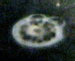

What has caused this panda-face in a cloud chamber ?

This image was posted on another forum , maybe someone here may be able to shed some light on the origin of the grinning-panda ...
The the cloud chamber does not have an applied magnetic field.
The radioactive source is Americium 241 [ from smoke detector ? ].
The duration of the camera exposure cannot be greater than one second (so I am told).
Personally I think the panda-face is an artefact caused by the radioactive source which has a similar size and shape to the largest* ring, but maybe some series of atomic events has created the pattern ? , ( the circular forms in the absence of a strong magnetic field makes me think otherwise ).
(* which is less than 1cm in diameter),

My theory is that it has something to do with Ancient Aliens :smile:
We are not ancient!
you sure its not a fake?
There is the magnetic field of the earth, it could be a low energy cosmic ray. Nice imagination to suggest a panda face !
The great panda god is calling us!

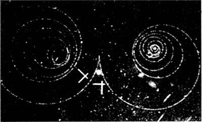

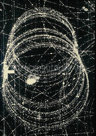

Americium 241 does emit gamma rays, which can produce electron-positron pairs, which have circular/spiralling paths in a strong ( 0.1 T) magnetic field ...
Electron and positron spiralling tracks
positron and electron being created by a gamma ray which came in from the top of the picture
Beta%20particle%20tracks%20bent%20in%20a%20much%20weaker%20magnetic%20field_1196(1).jpg
But the panda-face appeared in a home-made cloud chamber which does not have an added magnetic field.
andrien said:
It's a joke. Penguin diagram, Panda diagram.
lol,
