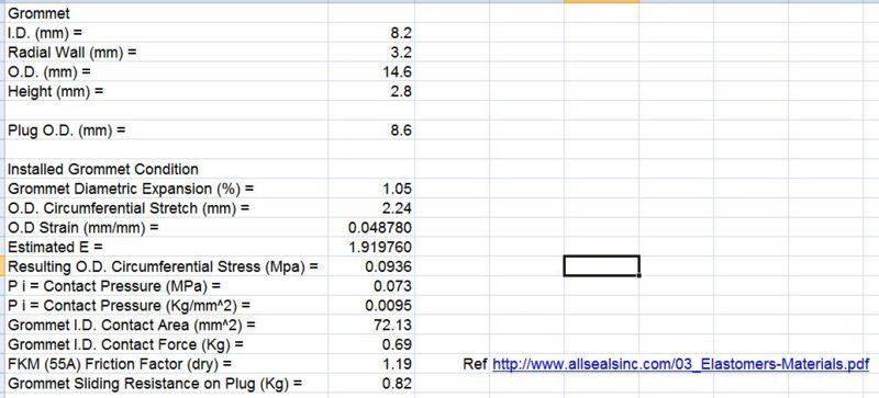

Hello.
I am finding out how many normal force between ring and cylinder. I try to find around for many hours but get noting. there are 8.2 mm inner diameters than put in 8.6 mm cylinder. The hardness of sealing element is 55 ShA. Contact area is 48.63 mm^2. I have data and drawing in attachment file. There are equation for this situation or not?
Regards
P.S.- I can convert to get Young’s Modulus. I got 1.919759658 MPa

So, I'm sorry for misunderstand. I find problem about Sealing element drop from production when garb from Packaging. So me study is to find max force to pull out sealing element from production. the resistant force apply with weight and fiction.
This is my study only compound not when assembly.

this sealing element, we called Grommet. But forget it. it made of fluorocarbon rubber or just soft rubber and Shore A-hardness is 55. (can convert to Young’s Modulus is 1.919759658 MPa) normal diameter is 8.2 mm and cross-section area of 1 side is 8.234 mm^2.
Cylinder is a protect sensitive part inside product made of stainless steel with outer diameter 8.6 mm.
this product will assembly with slot and there are lock clip. But the problem is before assembly sealing element is drop out in packaging from transportation or pick up force.
last one, this product used with fuel oil.

After some consideration I decided to analyze your problem as a thin wall cylinder with internal pressure, starting with the grommet's O.D. strain when installed on the plug, the resulting cylinder hoop stress, the resulting internal pressure, multiplied by the contact area of the grommet I.D., that resulting force x rubber on steel friction factor = resisting force of grommet to sliding off of the plug. Below is a screen print of my resulting calculation.

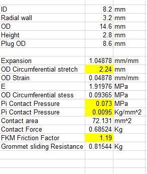

I don't know about Your Calculation of 1.OD Circumferential stretch 2.Pi Contact Pressure 3.Convert N to Kg and 4.where do you got Friction Factor.

I would have preferred to simply attach the Excel file so you could see all of the relevant calculations; but, some of the forum members are uncomfortable about the safety of posted Excel files.
1. The O.D. circumferential stretch comes from the expanding of your grommet I.D. to the size of your plug O.D. when the grommet is installed on that part. In the calculation it is the result of multiplying the uninstalled O.D. x the strain value above it. The amount of strain is the amount of stretch from the installation on the plug.
2. The contact pressure is the result of using the thin cylinder formula for the stress resulting from an internal pressure. Using the amount stretch (strain) and your E value I calculated the cylinder stress. Next using the thin cylinder formula, which is: σ = P x Do / 2 t. Where: P = the internal pressure, Do = cylinder O.D.; and t = radial wall thickness of the cylinder. By rearranging the formula to: P = 2σ / Do then I can determine the internal pressure on the grommet required to stretch it.
3. I am not sure to what you are referring, I didn't need to do any Newton to Kgf conversion for the calculation; and I didn't waste my time converting the Kgf value to Newtons when I finished; because, I see that as an unnecessary waste of my time. (Values in Newtons are totally unusable for calculations until converted to Kgf)
4. As to the source of my f factor, the reference website for that factor is on my #9 post attached calculation. (I don't know where you found the abridged copy attached to your post.)
