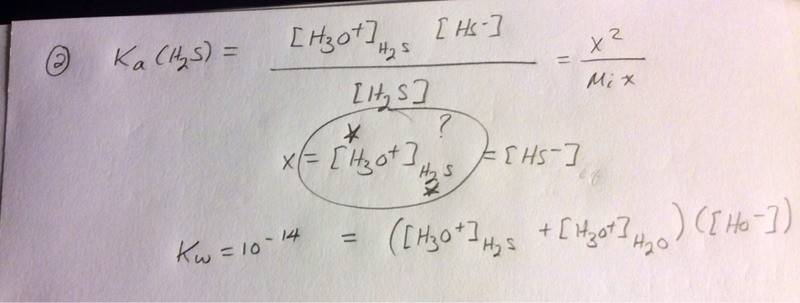

Find the pH of [itex]1.0 x 10^{-7} M[/itex] [itex]H_{2}S[/itex] solution.
We can take three approaches to this problem, one which is mathematically and chemically correct, one mathematically correct but not necessarily chemically correct, and one which is unequivolcally wrong. All involve the [itex]K_{a}[/itex] of [itex]H_{2}S[/itex]:
[itex]K_{a}= 1.1x10^{-7} = [H_{3}O^{+}][[HS^{-}]/[H_{2}S][/itex]
Approach 1:
Use charge balance and mass balance. Start from the below relationships and substitute into the Ka expression.
[itex][H_{3}O^{+}] = [HO^{-}] + [HS^{-}][/itex]
[itex][H_{2}S] + [HS^{-}] = 1.1x10^{-7} M[/itex]
Approach 2:
Realize there are two significant sources of hydronium ion - one source being water since the solution is so dilute - the acid ionization constant approaches the initial molarity of the acid - and the actual acid itself.
Use both the acid ionization constant and the auto ionization of water (Kw) to find pH. Use the acid ionization constant below with x = not to hydronium ion molarity but instead hydronium ion contribution from the acid.
Approach 3 (wrong but what a typical chemistry student would do):
Follow through on the below formula, with [itex]x = [H_{3}O^{+}][/itex].

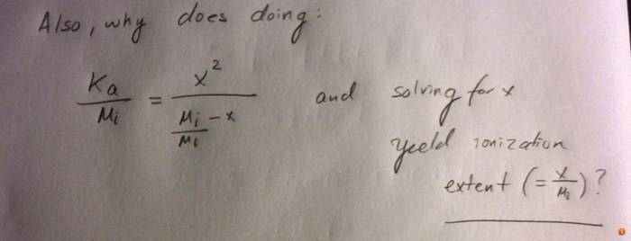

[itex]K_{a} = x^{2}/M_{i}-x[/itex]
Approach 2:
Now, I just showed my chem teacher this method, and although it yields the right answer, he told me it was unequivocally wrong.
I see what he's saying. We should only plug in the equilibrium molarities into our Ka expression. We can think what we want, but ignore the chemistry, and we run the peril of being wrong. We can delineate between hydronium ion contribution between the acid and water all we want, but the one thing we should be plugging into the Ka expression is neither of the aforementioned but rather the sum or equilibrium concentration of the aforementioned.
What do you think?

You have overestimated us! :smile: You have given us the hints and left us to do the calculations. We like to do it the other way round! :biggrin:
Since you seem to have done the calculations why not give them?
Because of the way itex works your X has become [tex]x[/tex]
I understand you to be saying that the Ka of H2S is 1.1X10-7. As I didn't know at first what you meant and didn't trust it (because you have made a mistake in your 3rd equation :-p) I googled it http://www.sciencegeek.net/tables/ka.shtml and found 9.1X10-8 which is close enough, there are probably several different values around.
You are right if what you are saying is that usual approximations are tricky to use here because of the extreme dilution making the protons originating from H2S of comparable concentration to those in pure water. I think you'd have to take into account everything present and do a full calculation if you want to calculate pH to 2 decimal places.
For rough calculations a chemist [PLAIN]https://imageshack.com/a/img84/3696/grindm0.gif sneer might say there are at most 10-7M protons that could original from H2S which additional to 10-7M in water, total cannot be more than 2X10-7M, -> pH not lower than 6.7. A more refined but still chemist's [PLAIN]https://imageshack.com/a/img84/3696/grindm0.gif handwavy circular argument would be to say that looks about half dissociated - [HS-]/[H2S] around unity fits with Ka/[H+] around unity at near neutrality (10-7M H+) and 10-7 Ka. So we'd have about 0.5X10-7M protons originating from H2S plus about 10-7M from water, 1.5X10-7M total and a pH around 6.8.
How close is this to the exact value you have calculated? :smile:

You are ignoring water dissociation. 10-7 is a correct initial concentration of H+, but any changes in pH will shift water autodissociation consuming part of H+, and 10-7 will be no longer valid.

This is becoming a "reinvent the wheel" thread.
I am not going to repeat whole (and full) derivation I posted here: http://www.chembuddy.com/?left=pH-calculation&right=pH-acid-base-solution, this is just the final equation 6.9:
[tex][H^+]^3 + K_a[H^+]^2 - (C_aK_a+K_w)[H^+] - K_aK_w = 0[/tex]
where Ca is the analytical concentration of the weak acid.
You can try to simplify the polynomial for specific cases. There is an additional discussion here: http://www.chembuddy.com/?left=pH-calculation&right=pH-weak-acid-base that shows which approximations work for which acids and which concentrations. Scroll down to the plot - white area is where typical approximations cease to work and you have to use above equation (but in most of the area solution is simply neutral).
