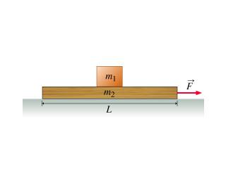

A small box of mass m1 is sitting on a board of mass m2 and length L. The board rests on a frictionless horizontal surface. The coefficient of static friction between the board and the box is U_s. The coefficient of kinetic friction between the board and the box is, as usual, less than U_s.
Throughout the problem, use g for the magnitude of the acceleration due to gravity. In the hints, use Ft for the magnitude of the friction force between the board and the box.
Find F(minimum) , the constant force with the least magnitude that must be applied to the board in order to pull the board out from under the the box (which will then fall off of the opposite end of the board).
I can't find any example of this one in my book, i must be missing forces. I tried doing each of the masses separately in relation to what they are on top of, but I am not getting it.

For this next problem you are trying to solve for when the sum of the forces is greater than static friction, such that the box on top slips away. Again, it's hard to know where you are having difficulties without seeing the approach you take.

Can anyone point me in the right direction for the second one?
Show us explicitly what you've tried so far. Then someone can probably point out where your problem is. It's much more efficient than for us to shoot blindly in the dark and hope we hit upon your problem! :smile:
