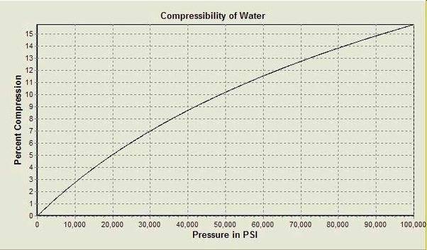

Trying to find the leakage rate of a pipe that loses 1psi per minute.
This is a situation I don't often deal with; I have an underground piping system that is failing a pressure test and losing pressure at a rate of about 1psi/min from 80psi. I'd like to calculate the leakage rate.
The pipe is a simple 10" diameter, schedule 40 steel pipe, 500' long (0.365" th). That's roughly 2,038.8 gal.
First, I calculate the compressibility of water. Googling, I'm seeing 2.8% compression for 1,000 psi (taken from a graph). Or 0.06 gal/psi. This feels reasonable.
Next, I use the hoop stress equation and 29 MPsi Young's Modulus to calculate the expansion of the pipe. I get a volume difference of 0.0019 gal. This feels surprisingly low.
Could someone double-check me please.

Double check coming up:
Compressibility (densities from NBS/NRC Steam Tables):
Water at 20 deg C and 1 bar absolute = 998.23 kg/m^3
Water at 20 deg C and 6.5 bar absolute = 998.48 kg/m^3
Water at 20 deg C and 70 bar absolute = 1001.37 kg/m^3
Change in volume = ##2038.8 gal * (1 - 998.23/998.48) = 0.51 gal / 80 PSI##
##0.51 / 80 = 0.0064 gal / PSI##
We differ by a factor of 10.
I used the hoop stress equation, 0.37 inch wall, and 30E6 modulus, and got 0.00185 gal/PSI. This agrees nicely with your calculation.
That's far too high. Even at the bottom of the Mariana trench the compression is just several percent, at ~1000 times atmospheric pressure or ~13000 psi. A factor 10 as error looks plausible.
I share the concern about gas being present somewhere.
Thanks guys; yep, I slipped a decimal place in reading off this graph:
That's 10,000 psi, not 1,000 psi for 2.8%.
Yes, it is possible there is a significant trap of air somewhere and that could cause a much higher volumetric leakage for the same pressure drop. I didn't measure, but the air vent was maybe a foot below the cap on the pipe, so presumably at least that half a cubic foot was full of air. 1 psi of expansion should be about 0.04 gallons. And there's no real telling if there is a significant air trap somewhere along the 500' length.
