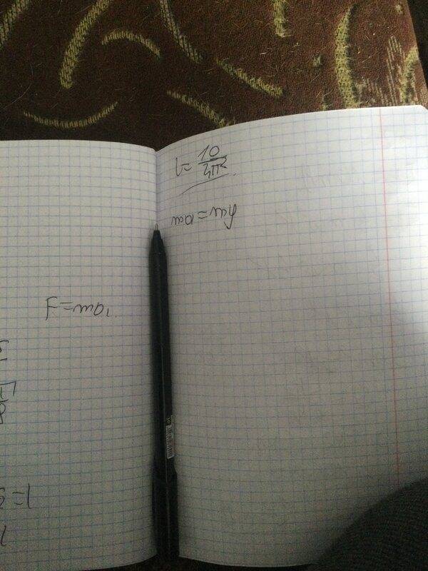

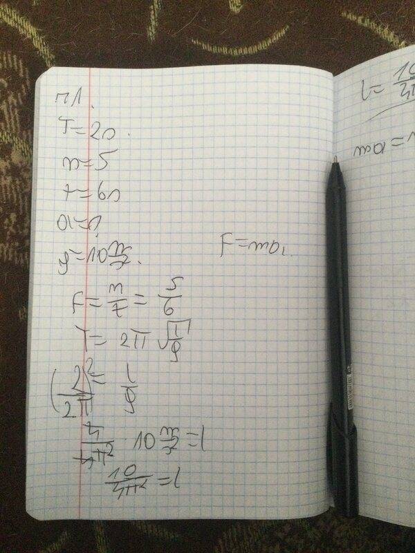

Before the rocket launch, the pendulum suspended in the cockpit made vibrations with the oscillation period of 2 s. During the vertical launch of the rocket, it was noticed that the pendulum made 5 oscillations in 6 s. Calculate the acceleration of the rocket. g = 10m / s2

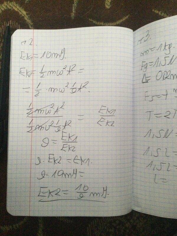

The maximum kinetic energy of a harmonically vibrating body is 10mJ. Calculate its kinetic energy when the pendulum deflection is A / 3, where A - vibration amplitude

Solutions in a file.

You haven't answered question 1. I'm not sure what you've done for question 2, but the answer seems wrong. Your working for question 3 is not visible.
Make some effort and type out your working.

In question 2, you have calculated what the maximum KE would be if the amplitude were only one third. That is not what you are asked.
