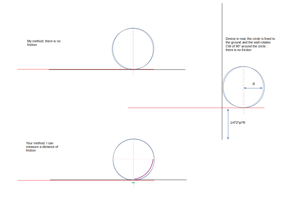

  • #125
jbriggs444 said:
The normal force from the wall does work on the circle as it translates horizontally.
It is odd. Anyway, you could compare the example with the needle+elastic and the example with the friction: it must be the same. If you say the up force works on one example it must work on the other. And think there is the force F3 on the circle.
I can, for example, use a fixed wall at top:
Like that I don't take in account the vertical force.
A.T. said:
Then the circle does rotate in the restframe of the wall, which allows you to see the relative motion better. Here the circle slides along the wall with a backspin. The backspin increases the slip distance, compared to pure slip with a non-rotating wheel.
Maybe it is what I called 'a slip' in the example of the friction (I'm not sure to understand your message at 100%). In the example with the needle + elastic, like there is no friction, I measure only the length of the elastic.

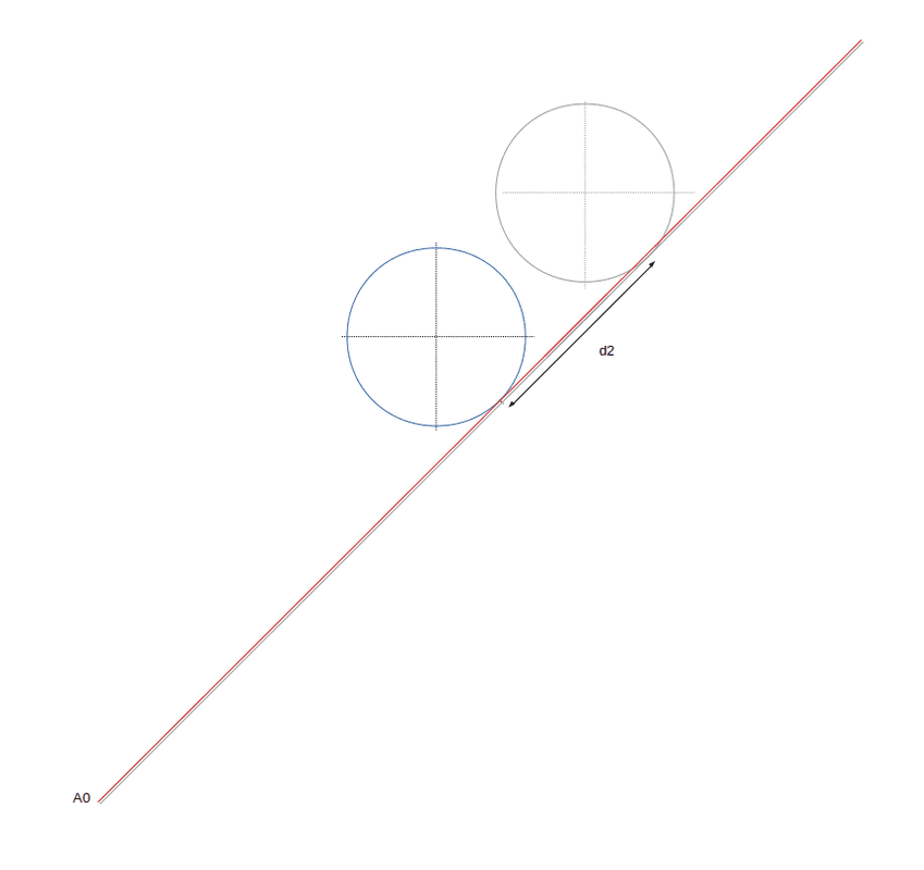

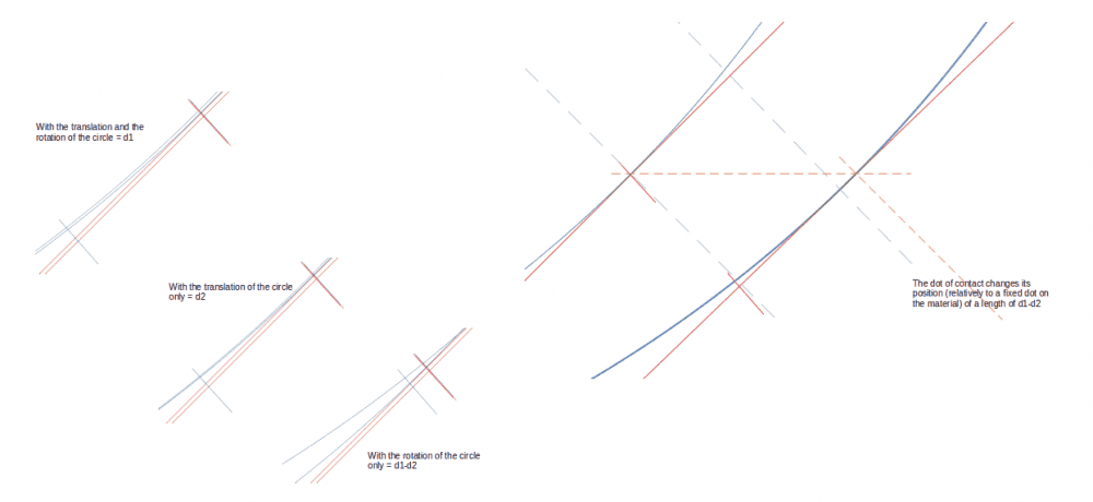

  • #129
Thanks for the method, I built something like that before but I didn't know how to do the intermediary steps to have the good distance of friction. First, I would like to precise the word "slip", I'm focus on the friction (for the example with the friction), so for me, the word I used at start is a slip in the friction, I mean less distance in friction. I see for you, the slip is the distance of friction. It depends on what we are focused. For me, the distance d1-d2 is a lack of friction. Just to precise.
I try to build the drawings, but I have a problem in the steps in need to do because I need to built with some steps in the drawings to have the cases you described.
So, for me, I start with the drawing with the start and the end positions:
I glue the circle and the red wall together of the end position and I rotate to have the angle of the wall at start, I move them to have the wall at the end position at the same place than the start position, I have that:
What I need to do now ? I move the circle alone in translation (x and y) to be at the position of the circle at start ? And I don't rotate it ? In that case the distance measured is d2.
If I rotate the circle after repositionning it like before, I have d1:
If I don't repositionnate the circle before rotating, I have d1-d2:
  • #130
"Slip" is the relative motion of the material parts in contact.
"Slip distance" is the time integral of the relative speed of the material parts in contact.

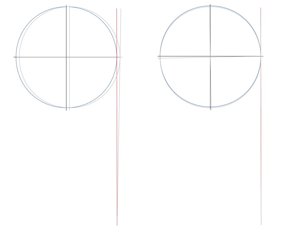

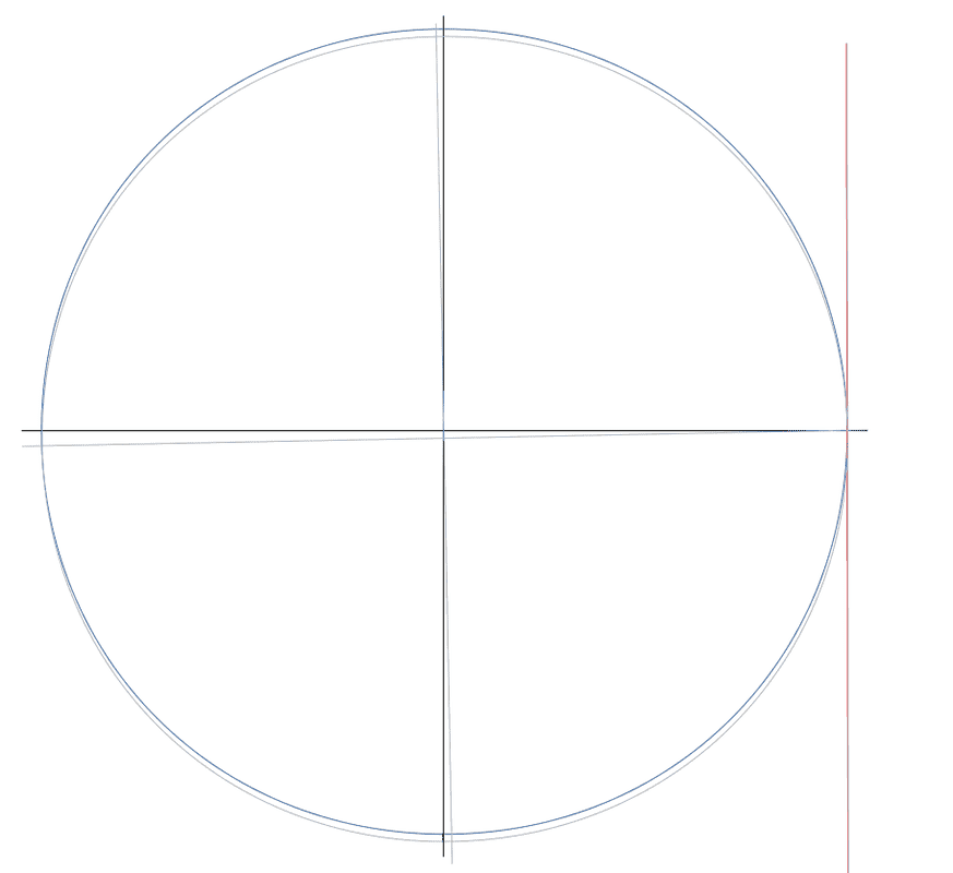

  • #131

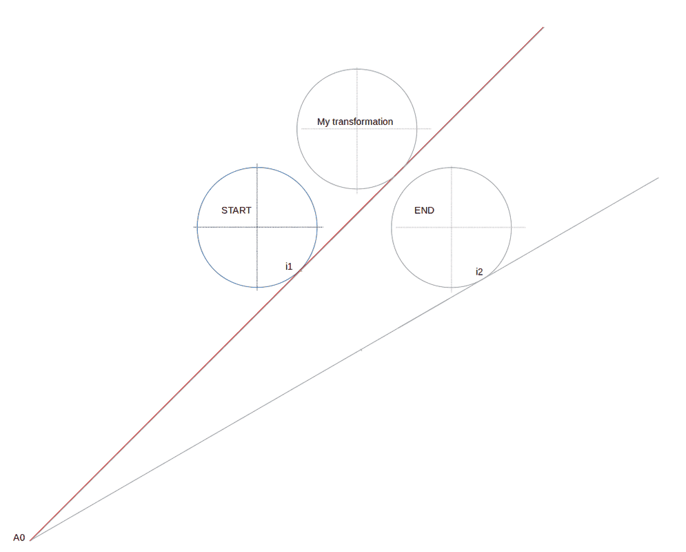

I have a difference enough to measured:
Your calculation doesn't take in account the position of the dot of contact relatively to the material. The friction between 2 surfaces depends of the position on the dot of contact too (not the trajectory), example: a wall rotate around a circle without any slip, so no friction, but with your calculations there is one. The distance of friction is well d2, because the dot of contact changes its position on the circle of a length of d1-d2.
  • #132
Your images are really not very helpful.
Draw the wall horizontally (its fixed in that frame). Draw the entire circle in two positions at least 1/4 radii apart and at least 30° rotated (backspin).

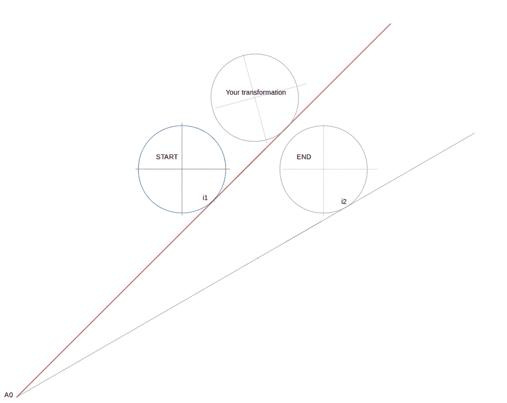

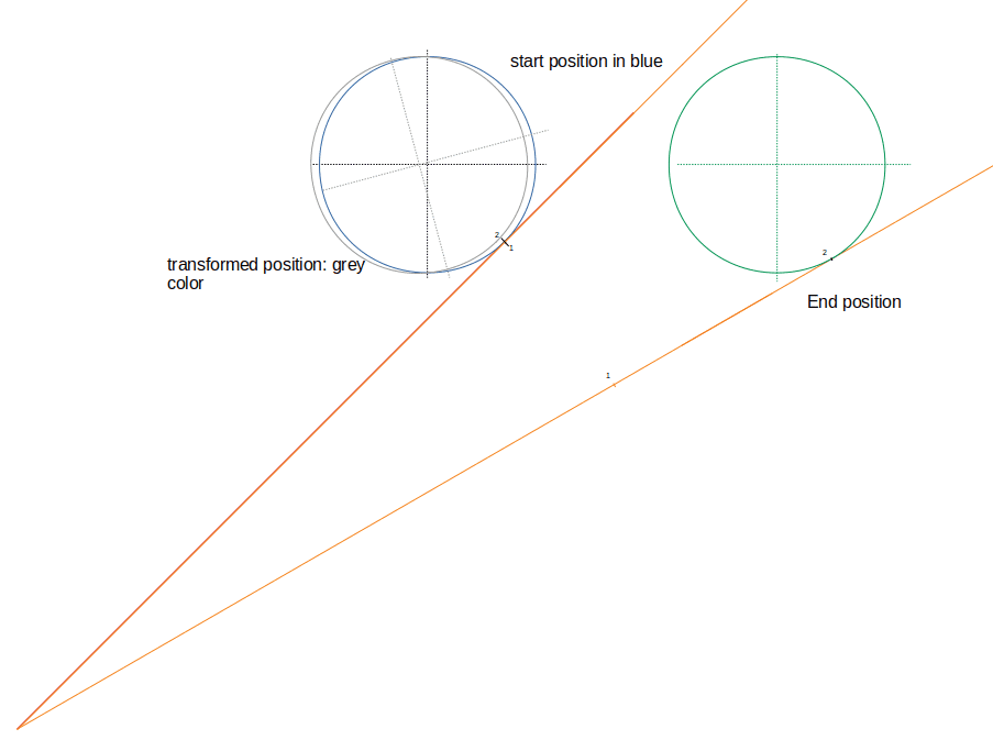

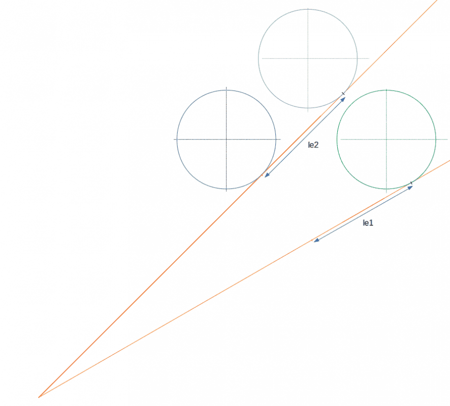

  • #133
It is difficult for me to think with the wall in horizontal position, so if it is not so difficult for you, let me draw it like it is on the first drawing, please.
I draw with a bigger angle of rotation, here I glue the wall and the circle of the end position, after I rotate the 2 objects to have the angle of the wall like the start angle, after I dettached the circle and I move it in translation x+y, and after I rotate the circle of the angle, but I'm not sure it is what you want:
Here, with the translation and the rotation, note there is the start position, the end position and the re-positionning position:
The dot '1' is fixed on the wall. The dot '2' is fixed on the circle.
The drawing with the translation of the circle but not the rotation:
Here, without the translation but with the rotation:
the last with the length le1=le2:
  • #134
JrK said:
... let me draw it like it is on the first drawing, please.
It's simply wrong for the rest frame of wall: In that frame, the wall is in the same position at both time points, not in different ones like you draw it.
Again, the relative motion between the contact materials is what matters. For example the motion of the circle material in the rest frame of the wall. You either accept this, or there is no point in further discussion, which is just repetitive now.
  • #135
Be careful: I drew 3 positions ! The start position, the end position and the position with the transformations you asked, the position transformed is exactly at the start position because the wall doesn't move, for example the translation but not the rotation, look I moved a little the transformed position (grey color):
Here the full drawing, to watch the wall doesn't move:
You can see there are 2 circles (grey and blue) because I attached to the circle the dotted lines to have the center.

  • #140
jbriggs444 said:
The relevant phrase: "translating circle".
I translate the circle, I don't rotate it. I let AT reply if it is not what he asked.

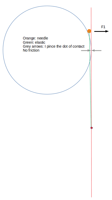

Jbriggs444: have you find the mistake with the example with the needle+elastic ? because you asked the vertical force works, etc.

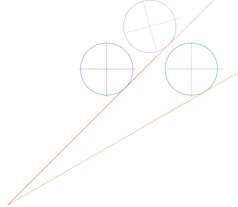

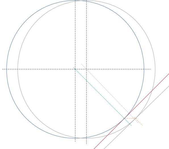

  • #144
Here:
The start position is the wall at 45° with the blue circle. The wall is fixed at 45° (the wall at 30° is the end position, I need it to built the drawing). The circle in GREY color at left is translating not rotating. Are you agree ?
And the distance asked by AT is 0 in the case 1/
The second case is correct too, if you consider the wall fixed at 45° (I drew also the end position): rotating not translating. and the distance is well the distance I measured from start: d2.
  • #145
As I understand it, you built the drawing by starting with the BLUE circle. However, that circle is just a reference from which you constructed the GREEN circle -- by translating right relative to the ground frame. And from which you constructed the GRAY circle -- by rotating 15 degrees counterclockwise.
The drawing is intended to depict the GRAY circle as the starting point and the GREEN circle as the ending point.
Yes, I agree that from a wall-relative point of view, this amounts to a translation without a rotation. I fail to understand the point of drawing two walls when the drawing is supposed to depict a wall-relative point of view.

  • #146
JrK said:
The grey circle is wrong. The transformation to the rest frame of the wall is a pure rotation around the pivot bottom left, such that the walls align. And the green circle needs to be transformed in the very same way. So the green circle ends up much further up-right along wall, not where you drew it. The distance of point 2 to the pivot doesn't change in the transformation.
This really trivial:
- Draw both time points in your frame
- Rotate both entire images around the pivot so their walls align (and ideally are horizontal)
  • #147
@jbriggs444: I don't represent the drawings like standards physicists do and I don't use the standard notations too, so I think it is more difficult to understand.
The second image, rotating not translating (start in blue, end in green, transformation in grey):
@AT: I don't understand: I choose the wall fixed at 45°, I drew the start position and the end position (arbitrary). After, I glued the circle and the wall of the end position and I rotate it of 15°, after I dettached the wall and the circle and I translate the circle to be at the same position than the circle of the start position, it is not that I need to do ?
  • #148
Yes, your drawings are more difficult to understand than the drawings that are being requested.
For instance, a drawing containing notations "le1" and "le2" without any verbiage discussing what "le1" or "le2" denote might as well contain neither notation. And indeed, if it is not translating then "le1" and "le2" are completely devoid of significance.
A drawing that is supposed to use the rest frame of a wall but in which a "fixed" wall takes two different orientations -- that simply boggles the mind.
  • #149
JrK said:
Now the grey circle has the right position, but wrong orientation. In the original image it was the other way around.
  • #150
Yes, you're right I don't explained, le1=le2 : I noted that. What is le1 ? it is d2. And what is le2 ? it is the distance of the friction (the slip that AT spoke). So, le1=le2 said the distance of friction is well the distance I thought.
You spoke about what image ? the image of the message # 147 is the second case: no translating, rotating.
The image for the translating, no rotating is the image in the message #144. It is the same dot, I'm sorry about that but yes, the distance in the first case is 0. Or I made a mistake in what you asked.
