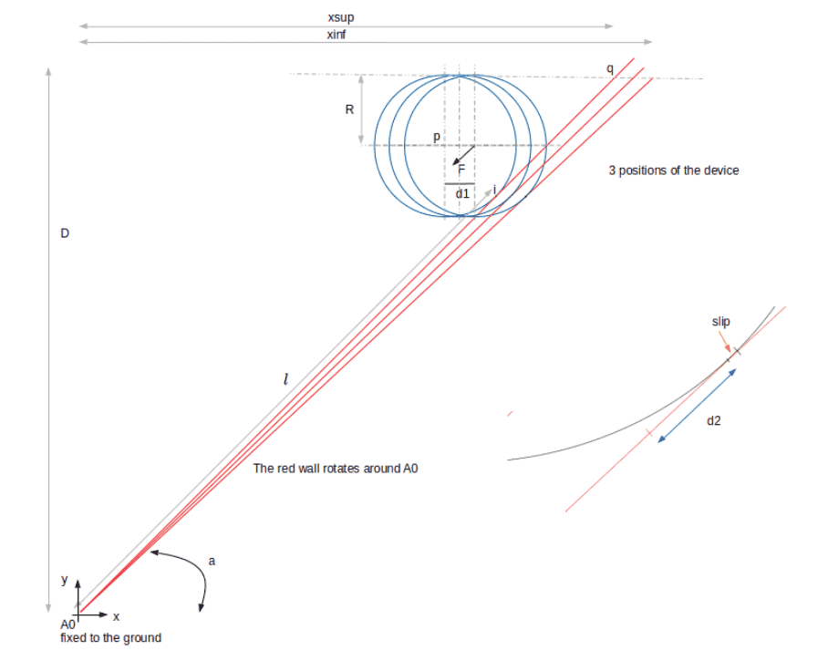

Hi,
It is my first message :) I hope you are all fine and safe in these difficult days !
I cannot find the good orientation of the vector of friction. A circle moves in translation to the right and in the same time the wall rotates around A0. A0 is fixed to the ground. There is always the contact between the circle and the wall. The circle doesn't rotate around itself, it is just a translation. There is a friction between the circle and the wall, I supposed the friction constant in value, not in orientation, for a small angle of rotation of the wall. At start, I thought the vector of friction has the same orientation than the wall but if I supposed that : the work from the translation of the circle is higher than the work from the friction. So, I think the orientation of the vector of friction is not like I think, how can I draw the good orientation of the vector of friction ? When I draw the length that the force moves along the wall I find a distance lower than I thought because there is a "slip" due to the modification of the angle of the wall and so the position of the dot of contact between the circle and the wall. So, is there a method to construct by drawings the orientation of the vector of friction ?
I drew 3 positions of the device with a small angle of rotation of the wall. And I drew an enlargement of the dot of contact:
Have a good day guys !
It's always parallel to the wall, per definition, and opposes the relative sliding motion.

The circle is driven by an hydraulic cylinder with a constant velocity (at least during the study). The hydraulic cylinder moves to the right the circle and the circle cannot rotate around itself, it is a mechanical constraint. I suppose the mass of the wall very low because I don't want to think with the mass nor the acceleration because it is difficult enough for me like that (but after why not). A spring (for example) pinces the 2 walls at the dot of the contact between the circle and the wall. The dot of contact between the circle and the wall changes its position for the circle and for the wall, so I suppose the "spring" pinces the 2 walls at the dot of contact just to have the force of friction between the circle and the wall.
This is the description you should have posted in right away. But all the answers were eventually given already: You have a constant friction force that opposes the relative motion of the contact patches (parallel to the wall).

If the force of friction is parallel of the wall, the rotation of the wall around A0 doesn't give any energy. Ok, so what work I forgotten ? The energy needed to move the circle is greater than the energy recovered from the friction because there is a slip. I measured the distances d1 and d2 and for a small of rotation 'a' it is easy to compare these energies.
The friction is not doing any work on the wall here. If the wall is mass-less and has no resistance to rotation, the normal forces don't do work on it either, because they sum to zero. Otherwise the normal contact force and the normal pinching force from the spring are not equal and opposite, and the remainder is doing work on the wall.
There is no energy recovered by the wall from the friction here. The energy recovered from the normal forces is still smaller then the input to the circle, because kinetic friction dissipates energy.

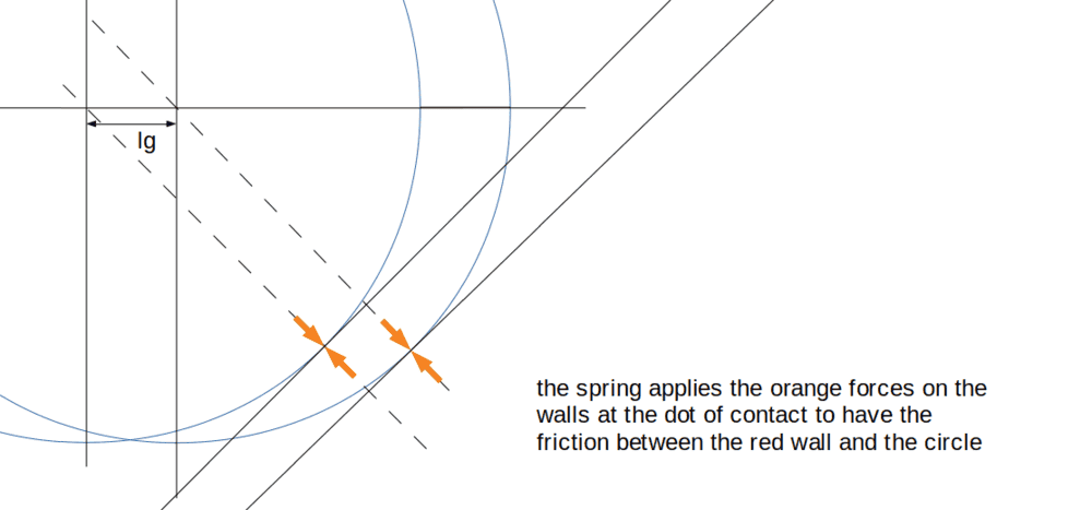

I press the two walls (the red wall and the circle) with, for example, a spring. The force of the spring is always perpendicularly to the 2 walls and passes by the dot of contact of the walls. The spring needs to move, to follow the dot of contact, and I think (I'm not sure) I don't need any energy to move it, and the length of the spring is always constant (in theory the length of the spring is 0).

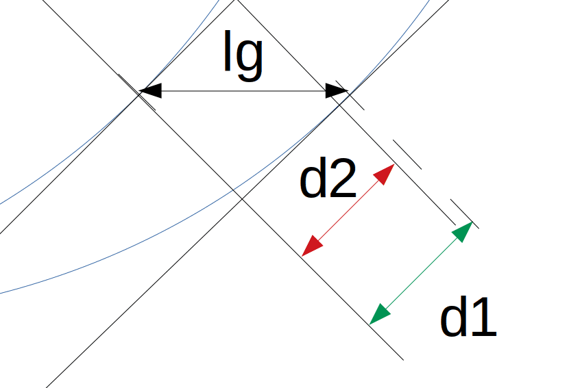

Yes, but I take the position I drew and I move a little the circle (and a small rotation for the red wall too). I think around the angle: a=45° . For example, like I drew, from 45° to 44°.
Edit: maybe we are not agree in the "normal force", for me the red wall has a very low mass (I consider 0 in theory), the normal force for me is the force I apply with the spring but that force cancel itself with the walls. The sum of forces on the red wall due to the presence of the spring is 0 because the circle cancel the force of the spring. And the sum of forces on the circle due to the presence of the spring is 0 because the red wall cancel the force of the spring.
If the net normal force (spring + contact) is zero, then only friction can do work:
- The work by friction on the circle is the integral of F_friction dot circle_velocity (should turn out negative)
- The work by friction on the wall is zero, because the F_friction creates no torque around the pivot.

OK, then as I said, only the horizontal component of the friction does negative work on the circle, according to the horizontal displacement of the circle.
Likes Lnewqban

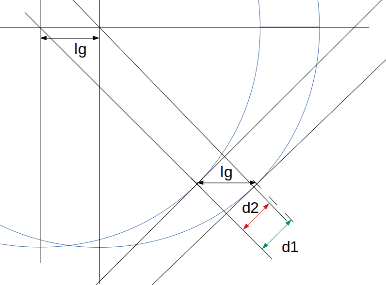

Yes, I'm agree. I applied the cosine function to have the horizontal component of the force. When I measured the energy to move the circle I need more energy than I have from the friction, it is easy to measure the distance and I take the mean of the cosine function.
For 1° from a=45°
d2=0.17
lg=0.27
I must have cos(44.5°) or near that value but I have 0.63 far from 0.72

Your d2 is irrelevant. Work is determined by the motion of the physical material to which the force is applied, not but the motion of the contact point (which moves along the material). Your lg is the infinitesimal displacement, but since the force direction changes you have use integration for larger displacements.

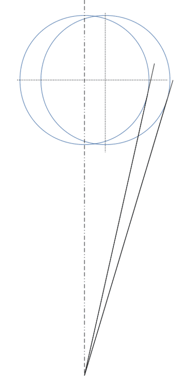

I built the drawing with a big step for the grid so I redrew it with a thin grid to be sure. I found a difference even I divided by 2 or even by 4 the angle 1° (around 45°) and the ratio of the energy from the friction divided by the energy needed to move the circle is always the same . But ok, it could be a mistake in the construction so I wrote a program to have the numerical integral, and like that I verified the angle of the force of friction:

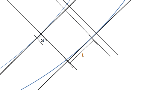

I have always a difference. I can take an angle of 0.0001° (around 45°) the ratio is always the same. And now, the program give near the same ratio than the drawing. I found a ratio of 0.917 with the program and 0.92 with the drawing and the accuracy of the drawing is +/-0.5% and take in mind I use the mean of the cosine function and it is not exactly that. I'm not able to have the math integral but the program doesn't change the result when I increase the number of steps. So, maybe I'm wrong in the drawing and in the program or there is a force that gives another small energy somewhere.

How did you calculate that? If using your d2, then it is wrong. See my previous post.
Yes, I used d2. I don't understand why the distance d2 can't give the energy from friction. I take a dot fixed on the wall at start (45°), and I measured the distance between that dot and the new dot of contact (at 46° or less). Could you explain more please ? and how can I draw it on the drawing ?
I suppose you mean "work" from friction because I used d2 for that. I used the physical materials: the wall and the circle. When the circle moves, the angle between the wall and the circle changes (when I'm on the circle, I see the wall rotates) and the friction has less distance to move because there is a slip due to the modification of that angle.
I explained this in post #23.
See also this recent thread where this misconception is discussed:

In the drawing, I measured the distance 'd2' but in the program I calculate the distance (at each step) relatively to a fixed dot on the red wall. Maybe it is not possible to draw the correct distance to find the energy of the friction but in the program I can calculate it, how can I do ?
JrK said:
Maybe it is not possible to draw the correct distance to find the energy of the friction ...
The correct displacement is your d1 (the component of lg parallel to the force of friction).
Thanks for your patience AT ! I read your link yesterday. Here, for my example, when the circle moves in translation, the movement (circle in translation and the rotation of the red wall around A0) is like the red wall rotates around the circle in the same time without any friction, I mean the rotation of the red wall rotates around the circle without adding a friction. It is for that I see a slip in the distance. I imagine well the circle moving in translation, and it increases its distance from A0 but like the red wall rotate around A0, the dot of contact, so the dot where the friction comes from, is closer to A0. Maybe the calculation could help me to understand.
