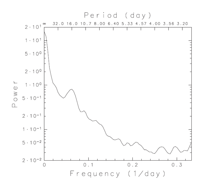

What is the software that has this kind of plot:
I want to use it for plotting graphs because it looks clean. Thank you in advance.
Edit: To avoid confusion, I want to know what software produces this graphing style, not the kind of plot.
jedishrfu said:
Well, I know that it is a semi-log plot. What I meant is what kind of software creates a graph in this style. For example, when Python plots points, a graph may look like this:
The line width, sizes, and fonts used in the graph are different from the graph that I presented. I wanted to know which software when it plots points, creates the graph that I presented.

As @FactChecker has said so succinctly, there are many many software plotting packages for a variety of languages that can do these kinds of plots and just seeing one plot would make it hard to identify which one. It could very well be a custom package too. Based on the typography it looks like a line plotter created it.

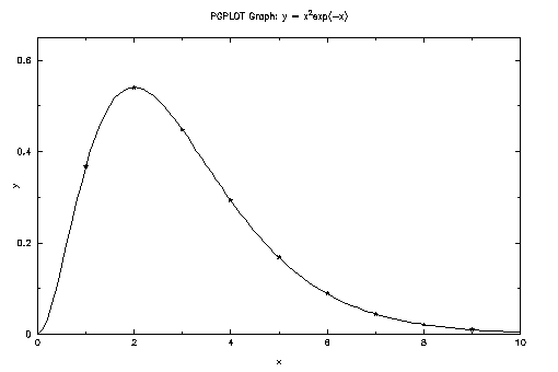

256bits said:
Investigate
http://www.astro.caltech.edu/~tjp/pgplot/ ( a little old maybe - 8 bit )
http://www.astro.caltech.edu/~tjp/pgplot/example.html
an upgrade,
http://plplot.sourceforge.net/
http://plplot.sourceforge.net/examples.php?demo=29
So there you go.
Check which plotting package your Python uses = is it plplot

Getting back to your original post. I think the software that created this was used to create reports for line plotters like the calcomp based on the typography of the labels.
Since plotters are no longer in vogue, you probably won't find software that will create charts in this exact style.
https://en.wikipedia.org/wiki/Calcomp
the 1976 manual has several charts that look similar in style to your chart (no loglog or double axes though) Page 5.76 shows their supported characters chart.
http://bitsavers.informatik.uni-stuttgart.de/pdf/calcomp/CalComp_Software_Reference_Manual_Oct76.pdf

As @jedishrfu said, it looks very much like the old line-plotter output. Do you know that the defaults would look like this on a modern system? I would be surprised if a current, supported, software package still had those defaults. But it is not difficult to specify plain graphs like that (although the font may be hard to match).

The plot reminds me of a gnuplot plot from around 1990, mostly due to the simply layout and the "plotter style" text font (I am not familiar with the actual name of that font).

Where did you get that example?
If I knew where it was from I could look at the metadata to see which package produced the file and/or that graph.
