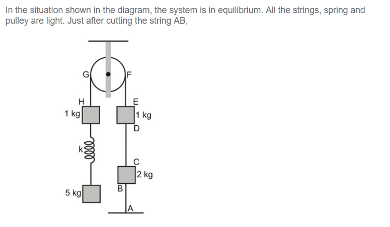

What is the tension in part GH?
The discussion centers on calculating the tension in part GH of a system involving multiple masses and a spring. Participants analyze the forces acting on each mass, emphasizing the importance of free body diagrams for accurate calculations. The tension in the spring is highlighted as a critical factor, particularly when the system experiences changes, such as when a mass is cut. The conversation reveals confusion regarding the relationships between the tensions in different parts of the string and the effects of gravity on the system's acceleration. Ultimately, the tension in part GH is derived from a series of equations based on the forces acting on the masses involved.
Suyash Singh
168
g is the acceleration due to gravity
a is the acceleration of system
Force=3(g+a)
Force=6(g-a)
solving both equations,
a=g/3
tension =force=4g
How do i calculate tension in the particular part GH?
and
what does the spring do here?

GH and FE are pieces of the same string. The mass of the pulley is negligible. What about the tensions in the pieces of the string?
There is tension in the spring, acting at both masses attached at its ends. Does that tension change at the instant when AB is cut? Watch this video
You determined the acceleration when all masses move together. But it does not happen at once when AB is cut, because of the spring.

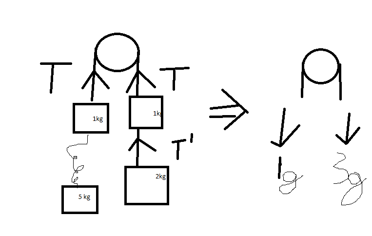

Chestermiller said:
OK. Let's see the force balance equations on each of the masses.
For right hand side,
Force=3(g-a) its falling
for left side,
Force=1(g+a) its rising

$$T-(5)g-(1)g=(1)a$$
$$(2)g-T'=(2)a$$
$$T'+(1)g-T=(1)a$$where a is the upward acceleration on the left and downward acceleration on the right. Do these equations make sense to you?

This is not what I get. Using the symbols and diagram in your post #8, I corresponding equations get are:
$$a=T-5g-g$$
$$a=T'-T+g$$
$$2a=-T'+2g$$
Do you see where T is not acting on the 2 kg mass, only T'?
Do you see where T' is acting on the 1 kg mass on the right?
Do you see where T' is not acting on the 1 kg mass on the left, but 5g is (the force exerted by the spring)?

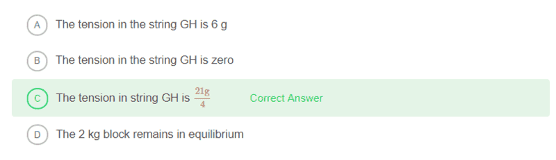

4a=T-5g-g+T'+g-T-T'+2g
4a=-6g+3g
a=-3g/4
  • #42
4a=-6g+3g
a=-3g/4
from equation 1
a=T-6g
T=-3g/4+6g
T=21g/4
