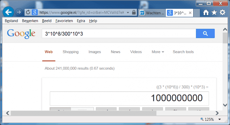

Well it says the dipole is short in comparision the the wavelength it emits... So: L << c/f ? But I'm not sure...
At 300Hz - L(upper limit) = 3*10^8/300*10^3 m (this seems obscenely big...)
Where am I going wrong? Thanks
Well, if I copy what you typed in and google it, I get
which is big indeed, but probably not what you meant ?
You are correct that is not what I meant... I missed out some brackets. Apologies for that. The calculation should have been: (3*10^8)/(300*10^3) = 1000m
So what am I doing wrong? 1km Hertzian Dipole is not normal in my limited experience.
