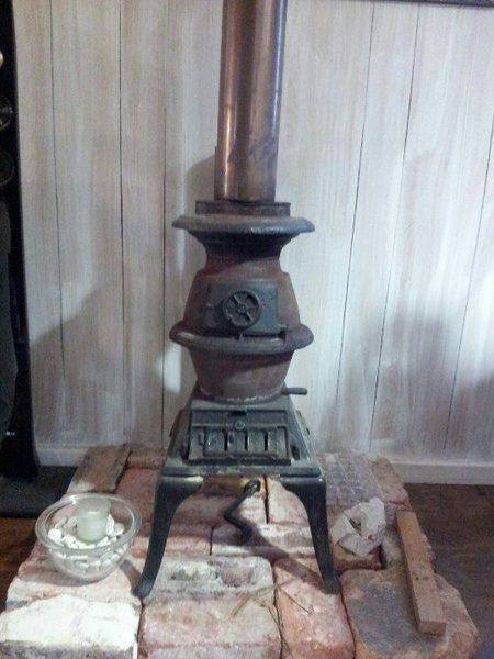

I'm sure the old cast iron pot belly stove/heater in my school classroom many, many yrs ago, got that hot and hotter
it used to roar something dreadful and glow bright red to orange ... used to scare the hell out of me
as a kid or around 10 yrs old
similar to this just a bit taller and fatter
View attachment 89772My soldering iron gets to 450C and doesn't even glow red
Dave
Yes but what about a bigger object ?
the pot belly was within close range to your measurements
us kids were sitting within 2-3 metres of it
According to this:
https://en.wikipedia.org/wiki/Red_heat
steel glowing orange is between 1708 and 1908 degrees F.
I had one of those huge cast iron fireplaces too, our cat would sleep directly underneath it.
A cast iron pan easily gets 400 degrees and not only can you put your hand almost directly above it with no danger, you can actually grab the handle, which is also cast iron and attached to the pan.
It would have to do with how small the room is and how well insulated it was.
