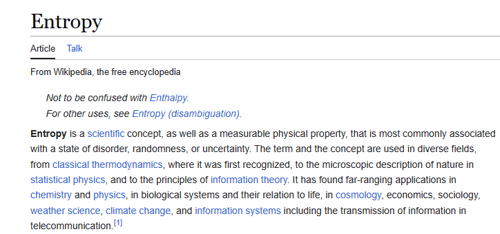

rolnor said:
Hm... Is that really true? Really?
And the wikipedia text, is that also "random thoughts"? I understand that wikipedia is not a source of high quality
Yes, I know what I had in mind when I wrote that :smile: And all of us are just random people from the internet. I think we can end that off-topic.
Not in general, because writers are supposed to write textbooks stuff, not what they think about the topics they are writing about. But the more technical the topic is, the less people know enough about it, so some of the articles are not a good sources to learn.
