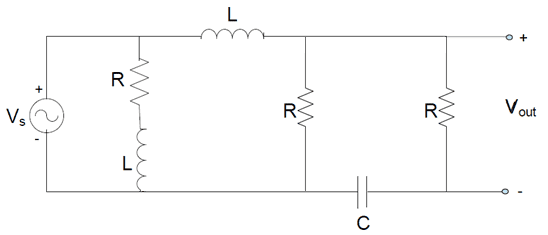

but when we want the get impedance of C and R of the right: - we connect that as series: Z(of C)+R .. why the different? please help!
Circuit schematic with a sinusoidal source Vs on the left feeding two branches: a resistor R in series with an inductor L on the left, and an inductor L at top with resistors R and a capacitor C to the right, with output Vout across the right-hand terminals.
Because inductance and resistance are different things and you cannot combine them as exactly the same the way you can when everything is just resistances.

In the 2nd circuit, it's not clear what you are trying to solve for. In general, that circuit will not combine down to a simple component or two. Could you label the different components with different numbers (so each resistor has a different number, etc.), and ask what you would like to be able to solve for in the circuit?

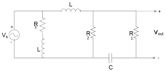

Circuit schematic with a voltage source Vs on the left, series inductor L and resistors R3 and L in a branch, R2 and R1 shunt branches, capacitor C in the bottom rail, and output Vout at the right terminals.
I want to find a simple arranged of total impedance on the
different circuit 1 (all R) and 2 (with the C and L).
in case 1 told me that R4 and (R1+(R2||R3)) as parallels. and in case 2 impedance R1 and impedance C is series. but I think about it if I will connect something to the Terminals the connection of R1 and C is like a Δ transform with R2 no?
(may that matter what the purpose of tow cases - case 1 what the total R , and case 2 what the transfer function. If that matter i want to know why)

The impedance for circuit 2 looking into which 2 nodes? It makes a difference... :smile:
No. Please reread post #2 and try to understand it.
Do you understand that the impedance of inductors and capacitors depends on the frequency, whereas the impedance of a resistor does not?
